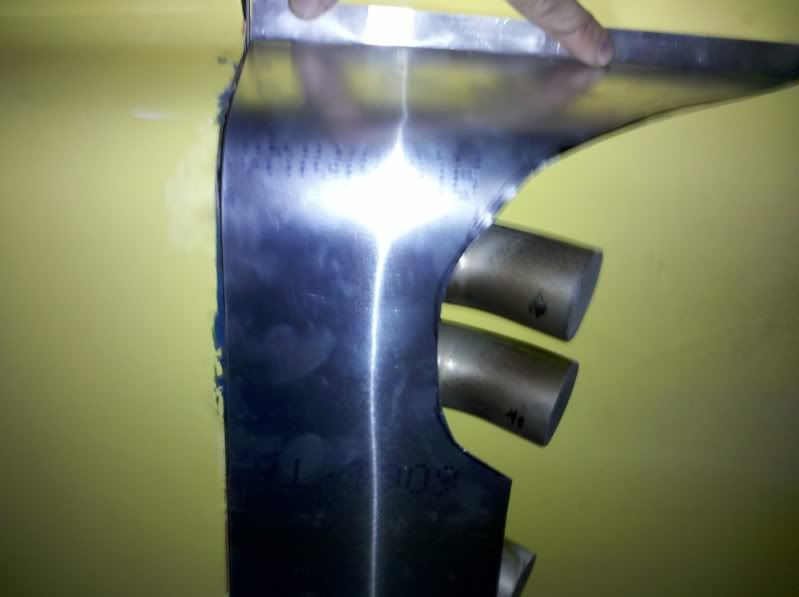

I managed to get to the hangar after all and started roughing out the AL prototype. Should have a flyable version on Tuesday. I have a 4 pipe exhaust so will be different than others. Also looking up the lower cowl, I have a very restricted and cluttered outlet. 4 pipes, engine breather tube, exhaust hangars and heat muff in a opening smaller than factory cowl....I've got work to do.
Sorry about the lousy cell pic.

Brian, also a good looking start. My first one fit inside the cowl, but for a prototype, you could use duct tape to seal the bottom and hold it in place for a try.
The only other drawback to an aluminum one is that, in my case, my transponder antenna is near the fairing. I flew with the aluminum fairing for about two months and did have one instance of "not receiving your transponder". I was at low altitude when it happened and suspect my antenna was blanked by the aluminum fairing.
