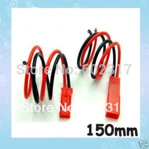

For the co-pilot PPT I used these RC battery connectors:

BTW, I used the RC battery connector shown below outside of the stick.
