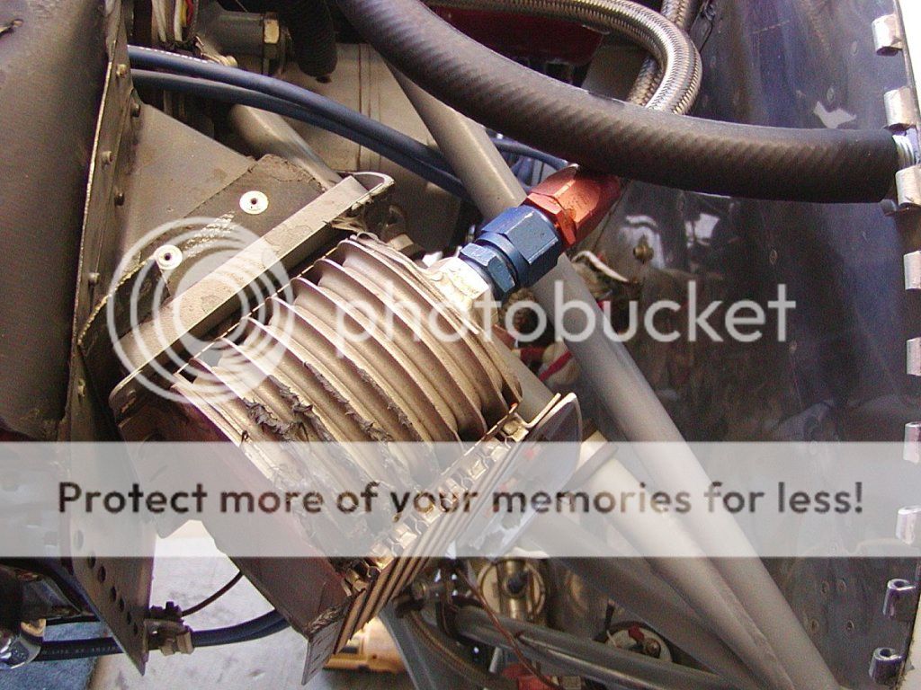

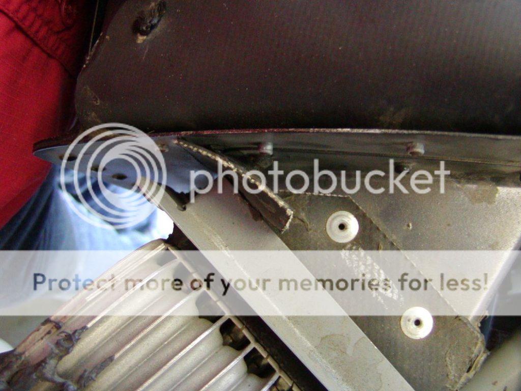

My next door neighbor has an RV6 with a 180 lyc. New engine, newly installed about 7 months ago. With less than 120 hrs, here's pics of the inside of 2 of his new ECI cyclinders where the nickel came off and trashed the engine. ECI has had them back for a while and so far he's just getting a runaround.
Man, thats nasty looking. What symptoms did he experience when this happened? Loss of compression and burning oil I assume?
Why the heck hasnt ECI forked over some new cylinders on warranty? Not sure what the delay/debate would be about. Hope he stays on them.

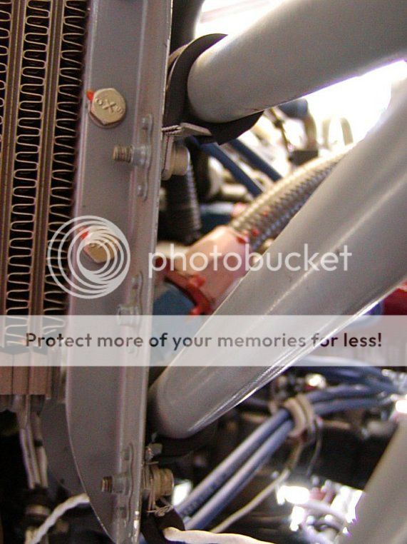

Paul,
Two ideas. If you are married to the baffle mount oil cooler, forget fancy alloys, the solution is called NEVERSEIZE. I see that problem all the time in my day job. Try removing the bolts which secure a motor mount to a 10+ year old alloy engine. Same thing happens. I always coat the shank of those bolts with NeverSeize and it prevents the galvanic corrosion.
Second idea. Do away with the vibration and heat that are transferred into a baffle mounted oil cooler. Keep the cooler in the same general vicinity, but mount it [with Adel clamps] to the engine mount. See photos of Gary's setup below.
Hope these photos give you some ideas to ponder. I tried to find a thread about doing this, but could not find it. I KNOW it exists, but the search engine failed me this time. I hope these two ideas help.
erich
It was burning oil and when he pulled on the prop it was obviously not doing well on compression (20 and 40 on those 2 cycls). Case is apart now. Pistons sidewalls are scuffed as is cam, crank and bearings. Looking ugly. Feel bad because he flew 400+ hours the prior 2 years on a 4 cyl Subaru with no real problems (other than dirt slow). We talked him into a "real" engine...oops.
