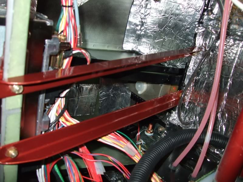

I have continuos foil backed soundproofing on the firewall,
then the same kind but just covering about a quarter of each open area between the ribs and stringers.
Just enough to keep it from resonating.
That coverage extends back to the seats. I also have foam on the footwell area that is thick enough to make the carpet even with the stringers.
Having an interior helps with noise too. I also have spent a lot of time sealing my canopy.
I also use good noise reduction headsets along with Entymotic Research earplugs. I added the earplugs after noticing how much more often I was saying "what" after taking four weeks to fly around the country.
