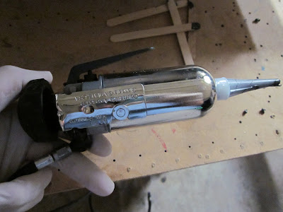

This is the tool that made all the difference for me when working with Proseal. Semco sealant gun Model 250-B. The 250-A model is the same but with the handle. The -B has a small paddle trigger. Also used a microgram scale with a tare feature so I could mix small batches easily. Before that, I hated it like most folks.

I am about to hit the "buy it now" button for one of these, but not sure just how it works. Looks like you would spend hours cleaning it up when you are finished. Do you buy the tips separate? Tell me more on how it is used.!
