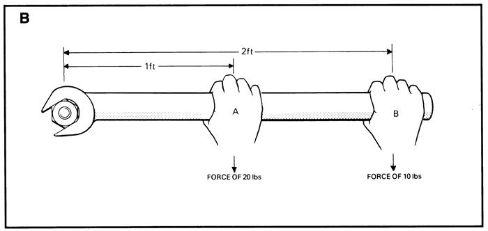

This is bizarre. At the risk of beating this to death, when a beam-style wrench says 25 inch lbs, it's 25 inch lbs - no more no less, and it makes NO difference where you hold the wrench. The only difference is that holding the wrench halfway down the handle will require exactly twice the force BY THE OPERATOR as when held at the end of the handle to achieve the same torque. The formula is simple Torque = Force X Distance X sine of the angle of the force on the handle (the sine of 90 deg is 1 so we usually disregard this). If the operator needs to exert 2 lbs of force at the end of the handle to achieve a given torque setting, then s/he will get the exact same torque when 4 lbs is applied half-way down the wrench handle...(2XL = 4Xhalf L) but the torque is WHATEVER the wrench reads. i.e., it has no idea where it's being held.
The torque in the illustration is the same at position A and B = 20 ft lbs.
I have NO idea what's going on with that clicker wrench in the video - that's just weird... but important to know.

A beam style wrench is measuring the torque by indicating the deflection in the beam. Therefore where you apply the load is critical.
For the clicker, intuitively you would think it doesn't matter where you hold the wrench because of the internal spring and pawl mechanism. But there are internal frictional forces (like the point where the wrench "breaks") that increase if you move your hand closer to the head of the tool because you have to apply more force for the same torque. I believe this is why there is a relatively large error shown in the video. If I add an extension to the handle the wrench breaks at a smaller torque than it is set to but the error is much less. On the request of BillL, I reran the test in the video holding the dial torque wrench at exactly the area on the handle marked as the active area by holding the wrench in a collet on my lathe. This was very stable and I got the exact same results as shown in the video.
