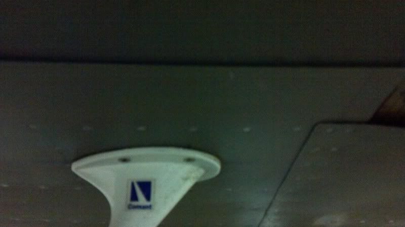

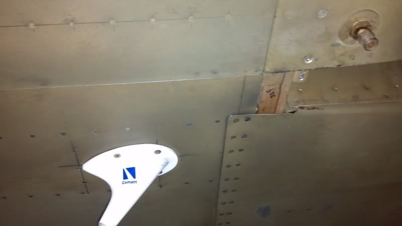

Default Todays Comm Test Results, Pics and Questions
Was only able to work outside about 30 mins before sleet and rain forced us back in the hanger, but testing with an icom handheld connected to the antenna coax on the radio end got some results that raised more questions than answers for a non EE like me who's just starting to understand ground planes, RFI and the like.
I have two Comant antennas mounted about 4" from the outside edge of the fuselage and 5" behind the spar, 36" apart. Both coax check good continuity.
All tests with engine off
Power off, connected handheld to comm#1 antenna, squelch at 0 - normal hiss.
Power on, no radios, no EFIS, no EIS - considerable static with regular popping or tapping sound.
Power on, EFIS on, radios off. - Lots of static, about twice as much.
Checked wiring conections and wiggled wires for 30 mins. while listening to static. - No affect.
Heres were I though i was living a Car Talk brain teaser episode...
When I kneeled on the wing to wiggle the antenna coax the noise became intermittent. (no jokes about my weight) Coax wiggling had no affect, but if I pushed down on the end of the wing the static would nearly stop!!??
Fuel tank senders? AHRS changing position? Wires in the wing grounding?
Wires not grounding? Global warming?
Nope.
It was the wing skin overlapping the fuselage making contact when I pushed down on the wing. There is about 1/32" gap between the skins that nearly silence the static when I push it closed with my fingers. But holding on the the end of the antenna does this also.

I'm not sure about the RV-6 design, but the RV-8 has nutplates and screws that join the lower fuselage skin to inboard wing ribs.
Paige

Noise and static are two different things as I pointed out previously. Based on your observations and descriptions Bill I thought you have an antenna and/or receiver issue. I deal with this sort of thing all of the time.
Now, why your antenna is behaving differently with the overlapping skin is contacting is straightforward. The antenna is either capacitively or inductively coupled to the ground plane. If the capacitance changes (poor ground connnection, ground plane changing size in this case) then something called complex impedance changes. Complex impedance changes will have a lot of effects on antenna performance. I can think of a couple other problems the skins not being well connected can cause but I digress.
Beyond the antenna issues I think I have heard in the past that the skin overlap screws are structural but you might want to call Van's on that one.

The RV-6 also calls for nutplates on the inboard lower wing rib and screws connecting the bottom fuselage skin to the wing. I don't know what structural affect not having them would cause but it sounds like it will solve you noise problem. Is this the kit started by Mike Wonder? If so I saw it at Lee Bottom in 2010.
