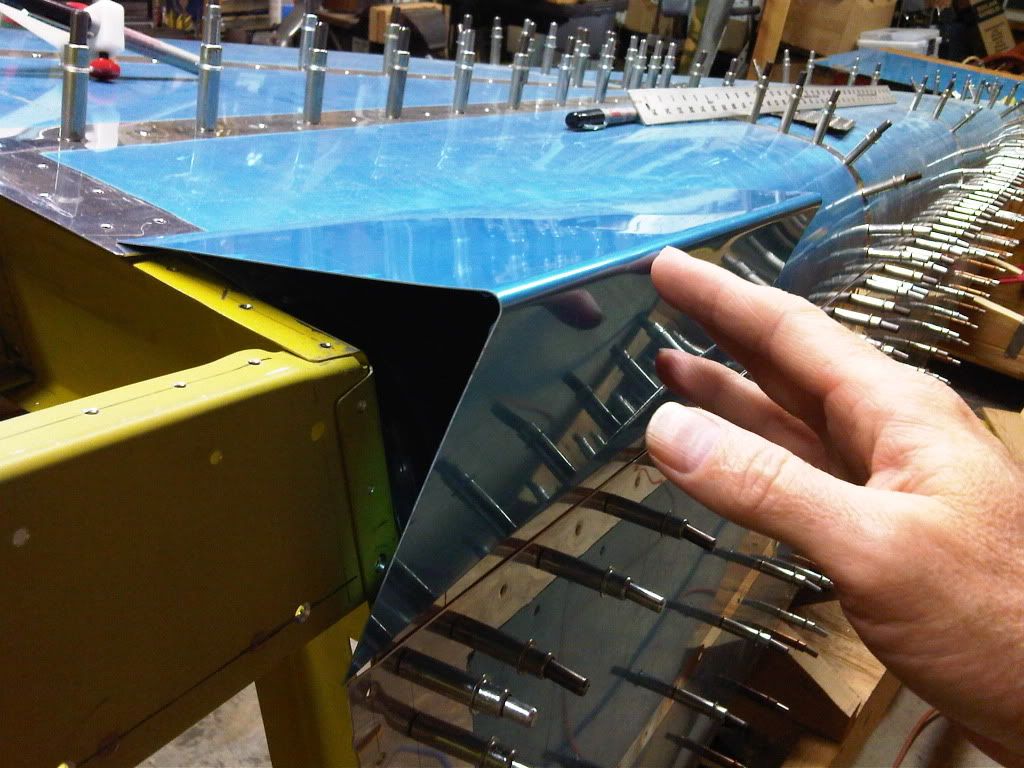

I still don't see why the fairings come with the finish kit and not the fuselage? It appears all the builders incorporate them before inverted the canoe! I had Van's forward them to me ahead of the finish kit. They showed up quickly, but bare little resemblance to the drawing. Mostly, they're bent to an acute 70 degrees but the installation needs an obtuse 125 degrees, tapering aft to nearly flat. Van's says they're correct as is. Can't be!

Perhaps you can post a photo of what you have got so we can confirm we are talking about the same thing. I actually made mine up from a de-skinned door off a crashed kitfox. I don't remember why, perhaps it was as you say they appear to come in the 'wrong' kit.

Default They have always come in the wrong kit
They should come in the fuse kit so you can attach them while the canoe is still inverted.
If they are about 15" long and made from .016 then you got the right ones.
Tuck the front under the bottom skin then push down hard at the back end to force the crease to just about touch the back skin.

Default Why the tight bend?
Steve,
I'll load pix tonight.
Carr,
Do you have any insight why they would be bent so much? I really don't want to use them after they've been significantly bent twice.

Default Over bent
I know I can force this to conform by un-bending it by half, but my question is why is it bent so much? As you can see, the aft end mates with the generous radius of the bottom skin so the fairing has to be un-bent from 75 degrees to an almost-flat 170.
Between this and the inexplicable reason the part is included in the finish kit and not the fuselage, Van's builder's support, isn't.
