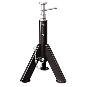

Old 03-21-2012, 11:21 AM
Phil's Avatar
Phil Phil is offline
Join Date: Nov 2006
Location: Waco, Texas
Posts: 1,658
This is what I used...
http://www.amazon.com/Camco-57371-Ol.../dp/B000EDUUL2
I put these on a 2x12 base. Then put a 2x6 between them and the bottom of the spar. It works great.
