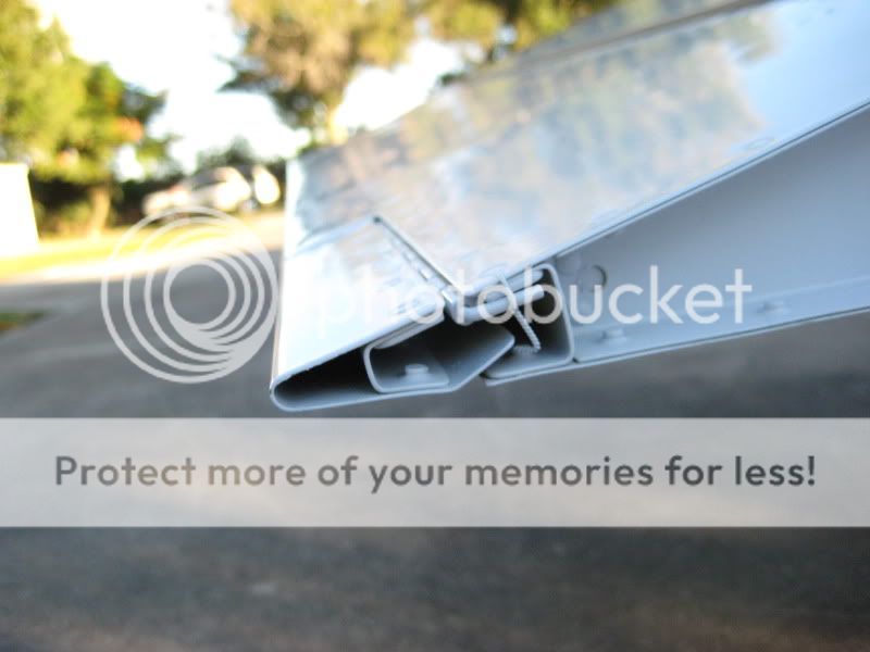

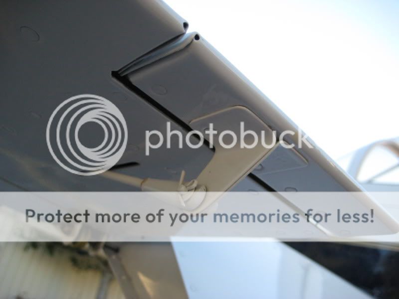

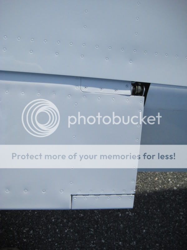

I went the aileron trim tab route and absolutely love it. I think 99% of folks will not be interested, but for the other 1%, it is the cat's meow. It takes a lot of extra work, but if you like doing this kind of stuff, go for it. I can have one tank full and the other empty and trim it out with my trim tab. Besides, it's so cool to watch the little tab go up and down in flight!
Here are a couple of photos. You have to add the little stiffener spar and I just made the tab to fit between stiffeners. Worked out to be just right.
