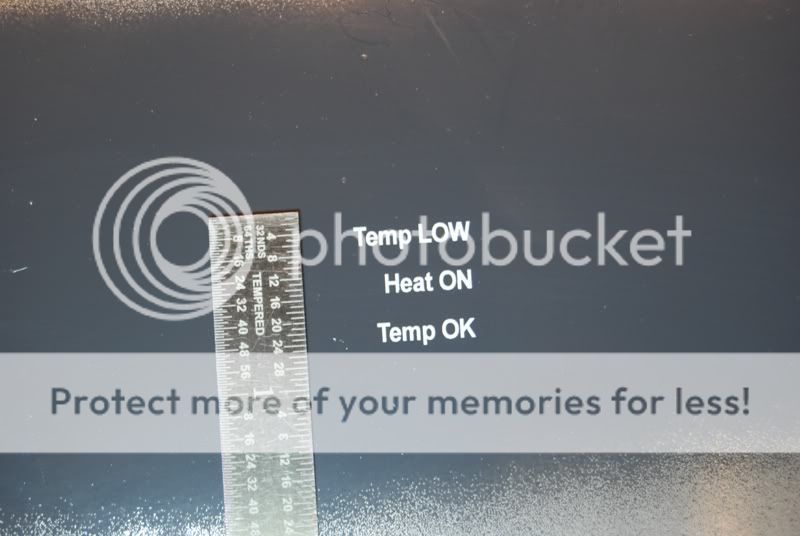

The DecalPro system has been discussed here in the past, with mixed reviews, but I'd decided that it was worth a try and purchased the setup some few months ago. The ability to produce white text labels for the dark instrument panel was the goal. Today I finally sat down to give it a test run, and can report excellent results. First I did one of the supplied test images in a nice red metallic foil, and it came out perfectly. I then printed out the text for the annunciator lights for the Gretz heated pitot in white, and ran it through the process with no problems. Two for two, right off the bat! Here is the annunciator image applied to a dummy test piece:
Since the text was black, I did the switch console with DIY water-slide decals with good results, but I'm sticking to the DecalPro system from here on out.

I have been considering the Decal Pro system for my panel. How durable are the images? Are you planning on shooting a clear coat over top? Keep us posted on your results. There has been a lot of mixed reviews on this system, however I'm still favoring it.

At this time I'm not planning to clearcoat over the DecalPro lettering. Despite the "Decal" in the name, it is actually a form of dry transfer, and is supposed to be quite tough when fully set-up. If it does somehow get too beaten up, it can be removed (91% isopropyl alcohol) and re-applied. I'll be top coating the waterslide decals, however. As to the learning curve, it wasn't bad. I read the instructions, watched the tutorial videos on the website, then followed along with the instructions as I went. Admitedly, this is rather more "fiddly" than a Dymo label maker, but as a lifelong modeler, I found it straight forward. I followed the instructions precisely, and got a perfect result on my first (and second) try. Allow yourself plenty of time first time out and don't rush it - a methodical approach should serve you well.

Hard to believe that we're all talking about the same product! As you can see in the picture above, the white label came out perfectly, and that was my second attempt ever. Just for the record, I have no financial interest in the company, and no axe to grind with those who like their stick-on clear labels; just wanted to share my results. As always, YMMV.
