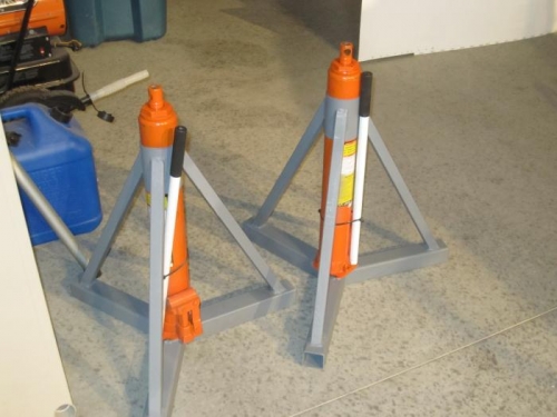

These were about $40/ea at Harbor Freight, then you just have to have a friend with a welder.
