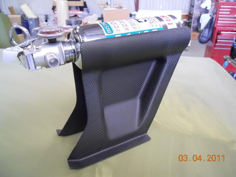

You have some awesome molded carbon fiber fixtures because of your many talents,, how about more pictures of all the "goodies" and make them available for the RV group for purchases?
Again, the many talents of this group amaze me, always.
