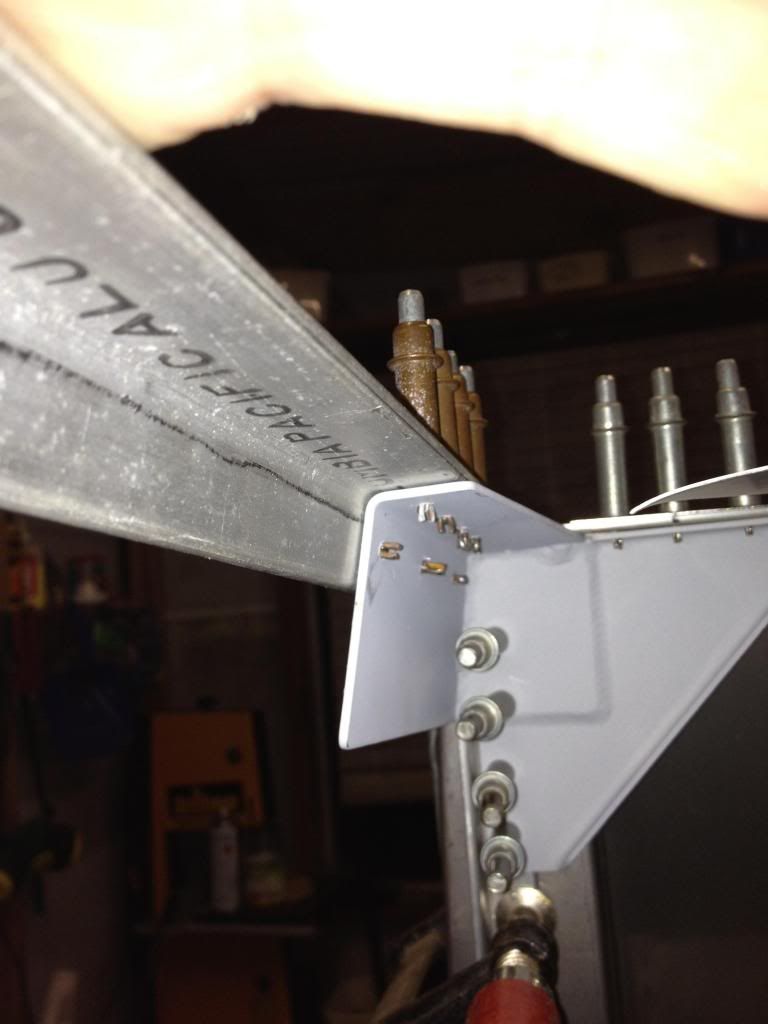

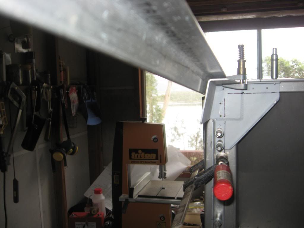

Derek Derek is offline
Join Date: Jan 2011
Location: Sydney, Australia
Posts: 86
Default Here are the before and after shots
I ended up cutting the weldment, adjusting it to fit, then welded it back together again.
