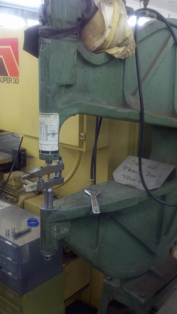

Old 11-30-2011, 08:10 PM
gib's Avatar
gib gib is offline
Join Date: Feb 2011
Location: Mesa, Az
Posts: 94
This is what I use.....of course it belongs to my company but it sure works nice. If money is not an issue than get one of these.
