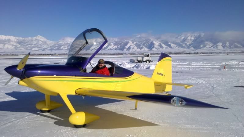

RV on ice.....Getting to be that time of year.
