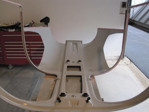

I tried searching Ivan's site, but could not find the photos Bob was referring to. I know they are there, but did not see them right away. You will need approx. .5 to .75" of flat area for the seal to install over. All of the curve needs to be removed. Use multiple layers of 6 oz. cloth on the opposite side to reinforce the door frame since you remove the material from the other side. You can purchase these in precut strips from west marine. After the you get close, then fit the doors in place. You will need them there to finalize the depth of the door frame and also the thickness. The seal does not need to be completely flattened when the door is shut. I suggest you purchase the center door latch from Planearound.com. Sean's latch is great for this seal. I actually was able to install the latch prior to closing the doors halves. I posted below the only photo that I took regarding the door edge and also the door seal installed. If you want to discuss, call me 314 605 7744. I also used the PPG JH202 high build primer then followed with a PPG DP epoxy sealer, then the color. Install the console after you get the doors and seals fit. Like Bob said, make sure you have the hinges installed and use Seans hinges, they will not require a spacer like I have shown in my photo.
So does that mean you would recommend not installing and painting the canopy until after the door stage?

As Phil mentioned, cleco the cabin cover to the fuselage and install the bolts in the door openings to secure the cabin cover from moving.
Then fit your doors. You are going to make a mess with triming for the doors and seals. If the interior isn't finished, you can't screw it up.
Once your doors are fit (with all the appropriate latches), then disassemble and take the cabon cover off. With the cabin cover off and upside down on a work bench, then you can easily work on the overhead installation. It's a whole lot easier doing it this way.
I highly recommend both Sean's center door latch and hinge for the gas strut. Also check out the height of your hinges. Most folks find that they need to take off about 1/6" or so to not have them sit proud of the cabin top. Ivan also shows some photos of using a router to lower the hinge area a bit.
Once you have the interior side finished to your liking, put it back on the fuselage.
For those looking for Ivan's dimensions, if you look at his door section, on the second or third page of his photos, there is a video there in which he walks around with a ruler. It's fairly hidden and you have to look close to find it. I was include a link, but that site is filtered here at work. I'm sure it's listed on VAF too if you do a search. This subject seems to come up quarterly.
