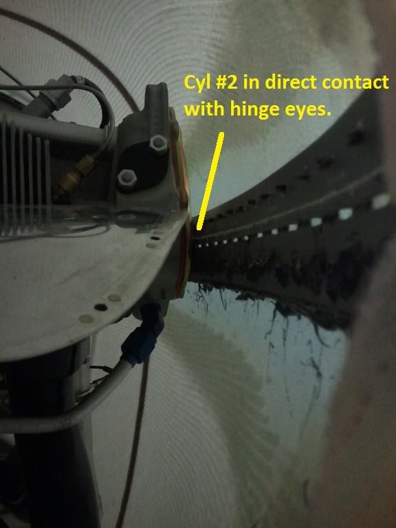

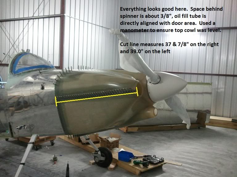

I need some assistance from anyone who has an SJ cowl on their 8. Specifically, Measurements along the cut line from FW to inlet on both sides. If you happen to have a Whirlwind RV200 and a Barrett IO-390, you're my new best friend.

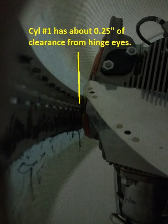

Long story short, after getting the horizontal hinges installed on the bottom cowl, I put it on the plane and the hinge eyes are in contact with the valve cover on Cyl #2, front LEFT. Cyl #1 (front RIGHT) has about 1/4" clearance. Theoretically, Cyl #1 should be the tightest fit since it is the forward-most cylinder.
Obviously, this cowl is unusable but I need to figure out what caused this before starting over. Any ideas?

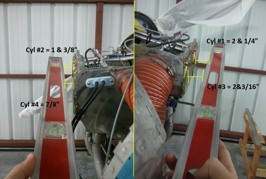

This may help explain what I'm seeing...

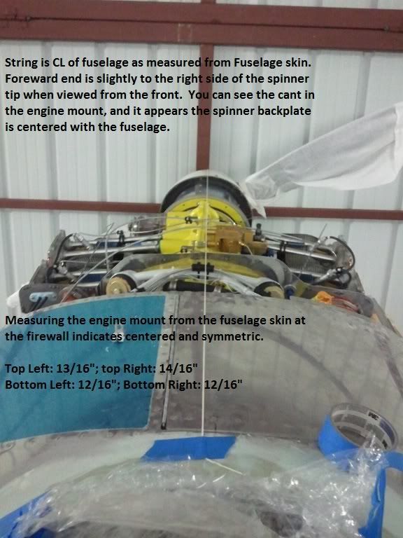

I checked my engine mount at the fuselage and it is symmetrical and centered. All bolts are torqued. 2.5" prop extension is installed as required by the SJ cowl for the RV-8.
In the pic below, I used a long level to extend the fuselage forward to the engine and then measured these values from the edge of the level to the center of the valve cover of each cylinder.

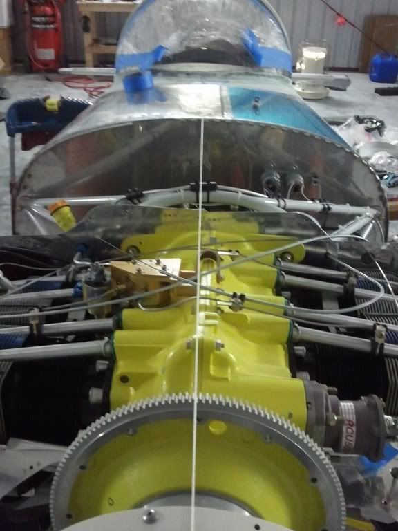

Bart,
Do you have pics from the front of the cowl around the spinner.
I would like to see the spacing there.
With some help just remove cleco's on the long side and push
back a 1/2 inch or so.
I thought I had the same problem with mine and adjusted more
after I had the spinner side gap perfect.
Thanks and I hope it helps.

I am no expert but my first impression is that your engine mount is not only canted right side down but is also pointed to the right of center. I would get some measurements of the mount itself and compare it to some others.
It would also seem impossible for the engine mount to be made improperly or bent but I had some weldments that were simply not acceptable in my kit. I threw away the copilot stick base and had to totally redo the landing gear mounts.
It would also be very unlikely that the firewall installation is crooked but,... is that possible?
Double check your engine mounts to make sure one side is not reversed on the top or bottom.
Don't throw away the cowl; I know one builder who had his engine/mount on improperly, fitted the cowl, corrected the mount problem, and had to rebuild the cowl. It was accomplished with not to much difficulty.

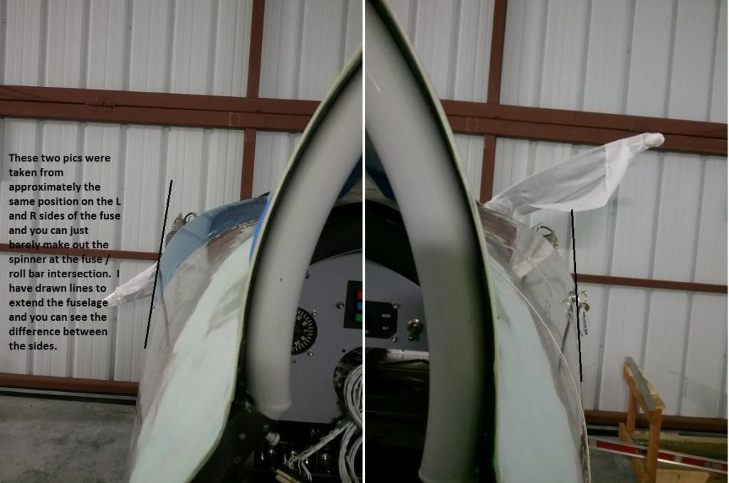

The engine on the 8 is supposed to be canted. The VS is put on perfectly straight and the engine is canted to overcome P-Factor. I originally thought about the mount, but with the firewall holes lining up pretty well and the back of the spinner centered, I believe it is right. I posted the pics to see if anyone else could verify theirs is about the same.
I also thought maybe the 390 jugs were slightly wider than the 360, but I understand they are identical. (Will confirm with Barrett tomorrow morning.)
I have a few ideas on making the cowl work. While I use a 1/4" spacer for fitting, it measures about 3/8th now, so I can fill and drill the rear of the cowl and pull one side out like Bruce mentioned. Someone else suggested placing a spacer and applying some heat, then letting it cool. I may also be able to remove some materials from the spinner holes and smash it down in the center to bow the sides out.
I'm still interested in confirmation of my engine mounting measurements and will call Van's in the morning also.
Keep the ides coming.
Bruce, as I said, spacing is about 3/8" back from the spinner and centered. Though centered actually leaves about 1/8 to 1/4 on the sides to play with.

I spoke with Deene this afternoon. His cowl was close, but not in contact and he had a few ideas. (Actually I've spoken with him a few times now this year.)
Other info of use:
Rhonda at Barrett Precision Engines confirmed the Barrett IO-390 cylinders measure exactly the same as the IO-360A1B6 (Angle valve 200HP)
Gus at Vans confirmed my engine appears to be mounted correctly, and confirmed that Cyls #2 and #4 will be very close due to the one point something or other cant in the engine and that some point behind the spinner tip will be centered on the fuselage. (Mine is!)
Will James confirms their cowls are designed for the angle valve 360 (and is compatible with the 390.) BTW, Will has been a pleasure to work with through this, but the best suggestions came from VAF.
I understand the engine rotates on the mount rather than shakes laterally or vertically, so not much clearance is really required. According to Gus, Vans removes core material in their cowls near the rocker cover edges to allow this movement as well.
Every 1/16" of an inch counts, and I'm shooting for 1/4" to be safe.
So here's my action plan. It progresses from least rework to most rework.
1. Firm belief that this cowl is salvageable.
2. Replace horizontal hinges with quarter turn fasteners leaving a gap in the mounting strip at Cyl #2 and Cyl #1
3. Check fit. If it fits with sufficient gap, stop. If not, proceed.
4. Leaving the left side vertical hinge pin in place, pull right side forward slightly.
5. Replace right firewall hinge half with wider piece and create a scarf joint in rear cowl edge, extend with flox and glass strips.
6. Check fit. If it fits with sufficient clearance, stop. If not proceed.
7. Pull both sides out closing the spinner/cowl gap. Fill as required. (It's fiberglass!!!!)
I did some fidgeting at the hangar tonight with adjusting the cowl. I believe the first modification will do the trick and have already removed the horizontal hinge halves from the bottom cowl. The Proseal was three or four (cold) days old and was still pretty soft. After drilling out the rivets and removing the hinge half, a razor blade followed by a cleaning brush and some MEK removed about 95% of the proseal in the area than will be required to bond the quarter turn attachment strips. I'm going to go ahead and replace the top cowl firewall attach hinge with quarter turn fasteners as well.
By the way, after drilling through all this fiberglass, my #40 bit was not doing a great job on the rivet heads. I touched it up with the "Drill Doctor" my dad gave me for Christmas a few years ago and wow, what a difference!!!!!! If you don't have one of these, put it on your Christmas list! (A new bit here and there is cheaper, but if you have several bits of various sizes and use them frequently, it's nice to touch one up while you're working.)
More to come, stay tuned.
