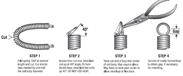

I forgot to mention that the Century Spring part number 6049 is too long and needs to be shortened. I could not find an exact replacement with the required characteristics, but the 6049 was the closest. Music wire doesn't need any heat treatment.
The picture below is from Century Spring's catalog.
