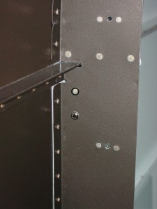

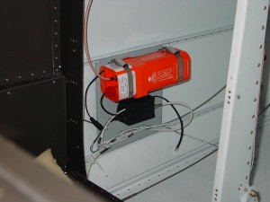

I mounted my APRS box (MicroTrak RTG) right below the ELT on Vans' mounting bracket. If you're using a similar transmitter, it's small enough that it could be mounted to a rib or bulkhead back there, as well, if you want it on the left.
Can't help much with the internal antenna; I bought one of the Antenex "Phantom elite" antennas that someone else on this site tried out. Mounted it centered in the bottom skin, underneath the baggage floor, with an NMO mount. The cable exits the mount parallel to the skin at a right angle, so it can easily be tied up and not interfere with the pushrod that runs through there.
Since my box is behind the baggage bulkhead, I modified it a bit to bring the LED indicator (which tells you if it's receiving a valid GPS signal, and also when it sends a packet) out to a connector, and mounted a remote LED at the side of the bulkhead. Along with that, a normalling minijack to allow for easy connection of the laptop for programming changes, without having to pull the baggage wall.
