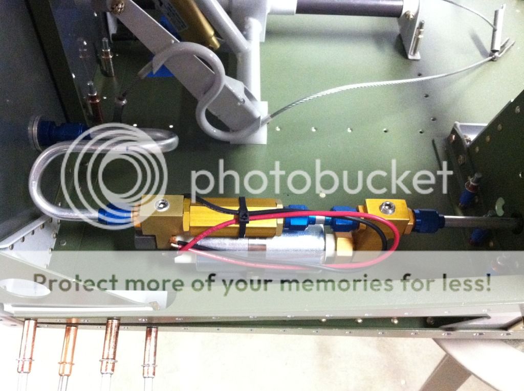

Default A picture
All:
I just finished this a few days ago and after a lot of trial and error, I feel it might be useful to share what exactly the finished line CAN look like. This was very simply to due with a 180° tube bender. Note that this is with the Airflow Performance fuel pump that Van's sells. After I finally figured out the shape, it took all of 10 minutes to fab the line and install it!
