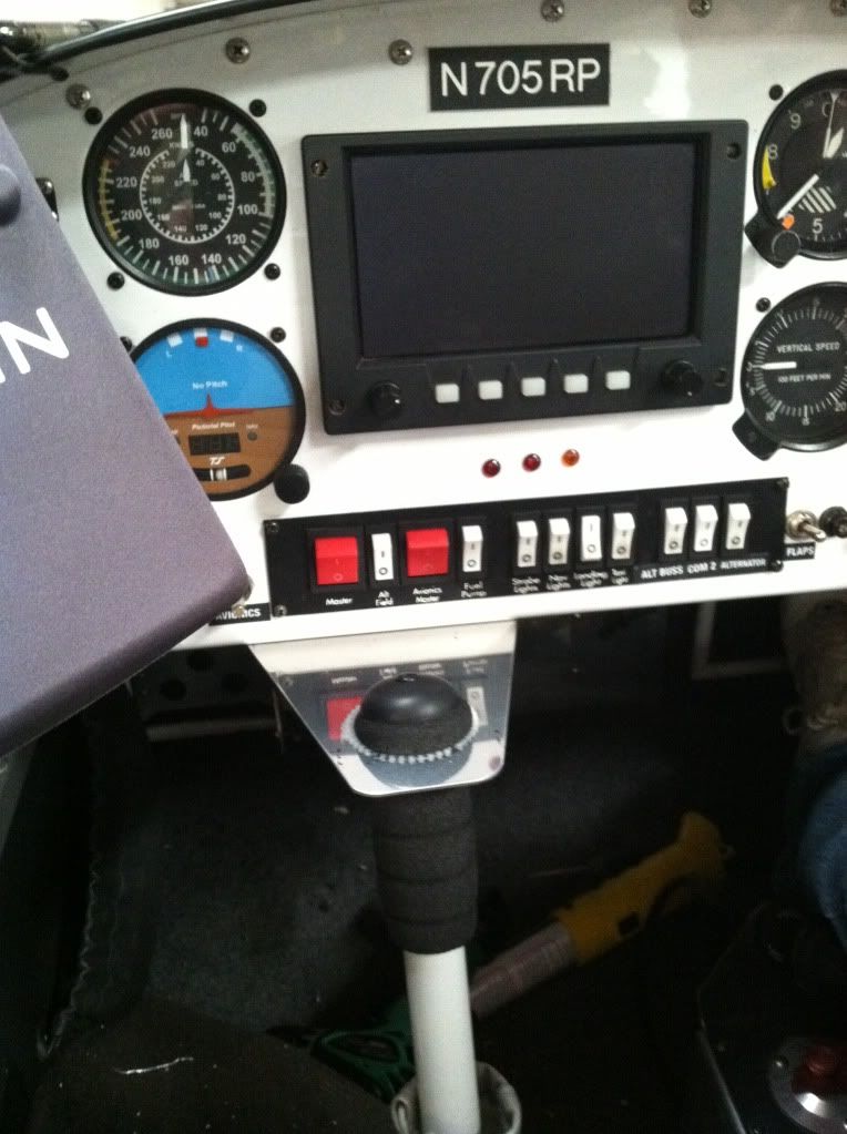

Bill, here you go:

Default Thanks Rick for posting photos!
The thumb screws came from the aviation department at Lowes.

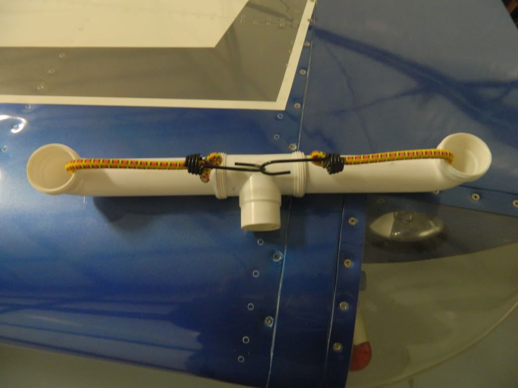

I bought the Air Gizmos but do not like them. I do not think they are tight enough and think they will eventually work themselve loose over a night of gusty winds.
I use the York from Spruce that work great and I trust them in any weather. It locks stick and rudder. I hate them though as they are a pain to put in and have scratched paint on the panel in several places trying to install and remove them. They are also heavy, expensive, and bulky.
I built a pvc version of the York (actually on version 2.1) and use bungies to hold it in place. I use this for day trips as it is easy to use. With the bungies I think it has too much play and therefore will work itself loose if there was a long period of gusty winds.
Still looking for better ideas.

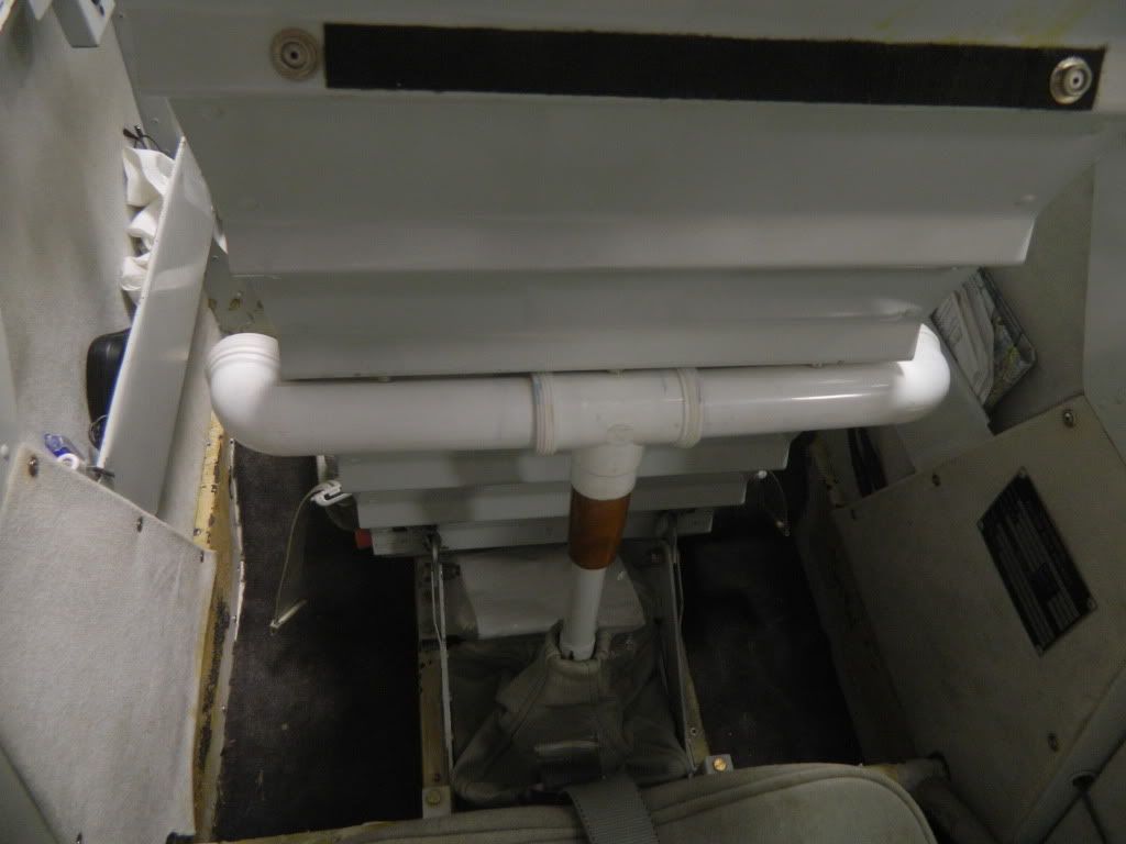

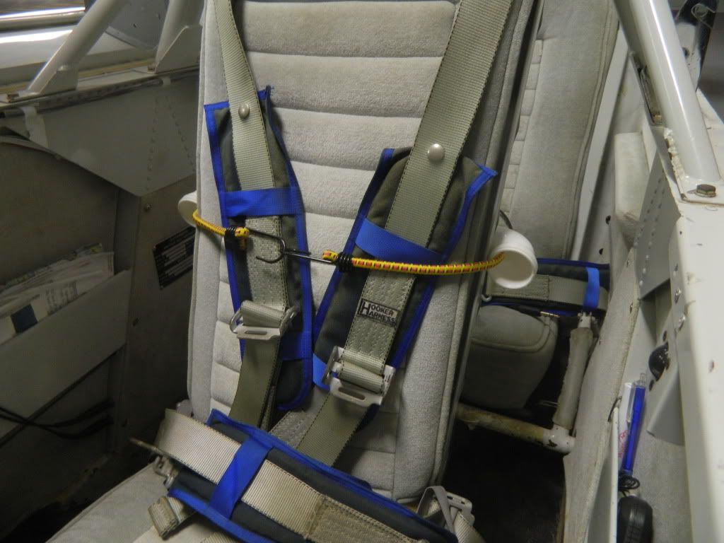

Default Control lock for RV-3,4,8
I made the following from plumbing extras from building my house. I didn't glue it, the bungee keeps it together. If worried about the rudder, I use a seperate rudder lock ( the puck type). - Ben

I know its been done a million ways and for 80 years, but I loathe ANY lock that is internal and attached to the stick/rudder. My thinking, probably wrong, has always been that in terms of extreme gust, particularly from the rear, the loads on the control surfaces have got to be fairly brutal as they try to whip airlerons up or down and rudders left or right, in reaction to those wind forces. Sure, the surfaces can't move much due to the control stick being held in place, but what kind of beating are the actual control surfaces taking?
My other issue with the seatbelt/mechanical internal lock, has been when those methods are used in a manor that results in full UP elevator. What happens when the wind hits from BEHIND and slams into the tail with full up deflection. I can tell you. I've seen the results on others aircraft. $$$.
I've always tried to use external locks for these reason, and home-made when possible. I loved Pierre's idea and the Air Gizmo looks totally worth consideration. Thanks again all!
