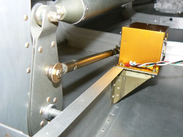

Any one installed a Trio gold pitch servo is a 9A. Just wondering if you might have good mounting deminisions especially the distance between the servo arm and the bell crank.

I mounted the Trio Gold servo in my -9A. I don't have the dimension you are asking for, but it was not hard to adjust it close before installation and tweak it after it was in the wing. Works great!

Not in a 9, but in a 10, I used VANS AHRS bracket. I think the 9 has similar? Its a little bigger than you need, but the placement is good. So cleco it in, position/mark the servo for nutplates. You need to add one or two angles longitudinallly beneath the plate. The servo needs to be on a stiff mount.
This had to be changed to a higher hole on the bellcrank and the center hole on the servo arm to work right.

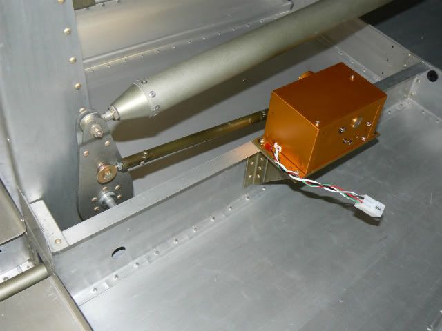

Here are a couple photos of mine. I think the directions from Trio indicated placement.

This is still work in progress for me, but I've just installed the mounting bracket that Trio provided with the servo.
Here is a pic of my setting.
I've measured 7" from the center of the mounting plate to the vertical axis of the arm.
As you can see, I've made a provision of 3 holes in case I need to adjust the rod anchor point, and also used a bigger doubler than the one provided by Van's.
You can find a picture of an RV-6 setup at page 71 of the Pro Pilot Operations and Installation Manual availabe on Trio's web site
