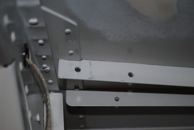

What did most of you do to integrate the lower F-450 longeron into the F-404 bulkhead: Sandwich in between the U-plate and the -404 flange or just rivet against the U-plate/404 web flange stack?
I assume you want a minimal step off the U-plate for skin smoothness so wouldn't the sandwich approach be best? Same question concerning the floor rib, F-415 on the aft side of -404? Also, did you slightly bend the longeron at F-402?

Forward angle extrusion is notched, rear is bent, shim sandwiched below. No right or wrong method; builder to choose.

Thanks, Brian. But I was asking opinions on the lower longeron (top-most while in the jig), the F-450 with the 1" flanges and obtuse angle on the very bottom. I think you're showing the 3/4" longeron. I know these transmit a lot of load into the F-404 but the most attention goes to a smooth skin transition. Just looking for some options.

I can email a few more photos of the area you are questioning. Too much hassle to post. On the side, I cut a step in 450 (table saw). 450 is straight, no bends in either plain, from 404 to firewall. The bottom of 450 does not overlap the bottom flange on front 404 bulkhead, which also has the narrow sheet piece that holds them together at the bottom. I used a gusset at the intersection of 450 and 404 bottom flange.

Here's what I did on my 4. For what it's worth, It's the way I decided to make it work, you may want to do something different. Did a lot of research before I finalized it and it's the best way I found.

I'm currently at the same stage of construction as you. I found a picture of the F450 intersection (someone elses aircraft) on this forum, hope this helps.
