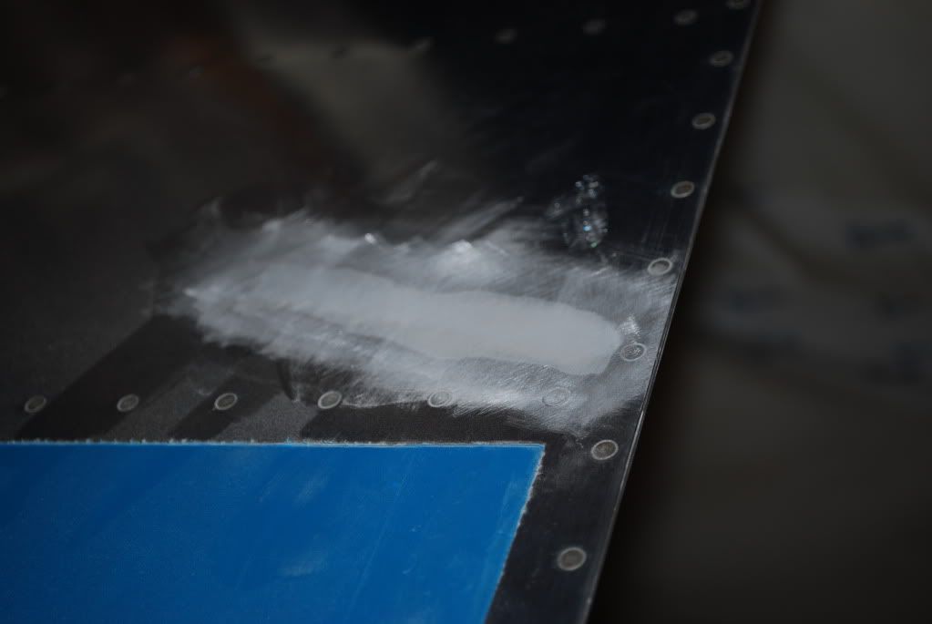

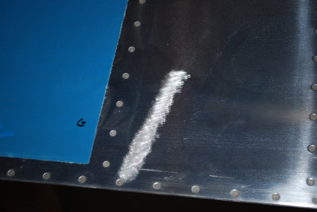

Default UPDATE WITH PICTURES....
Thanks for all the replies guys.
First of all, I have dealt with the situation by talking to the kids and their parents. I did not blow a fuse. I tactfully spoke to them about what was done, how much those parts cost and the amount of work that goes into them. Not once did I raise my voice or get mad. I don't want the kids to think they can't come into my shop when I'm there or that airplane builders are creeps. It was not done intentionally so I needed to act accordingly. Everyone understood what happened and I am sure it won't happen again. I let the kids watch me fix the dent (next thing you know the plane will be covered in microballons and epoxy ). Anyway, I am satisfied with the outcome, the kids are not afraid of me or airplanes and the parents and I remain friends.
Finally, here are some pictures of the fix. It is perfectly flat even though the pictures don't necessarily show it. Once primer is on this...you will never know it existed. I sanded the dent and crease with 80 grit (lightly). I then filled it with microballons and epoxy and sanded it down with 180, 220, 320 and finally 400 grit.
Being a perfectionist, this was a real learning experience for me and I felt that I grew as a person and in my builders skills. I learned patience and forgiveness as well as accepting imperfection and the end result is that I am better for it. As a builder I learned that I am not afraid of dents because now I have the skills to fix them.
Now its time to move on and get this thing done...
