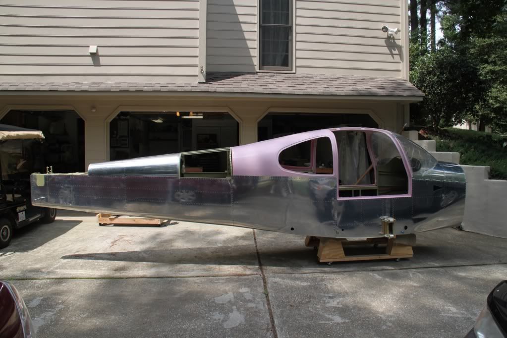

Default Making Progress...
Bring on the doors.

  #334
Old 10-06-2011, 09:53 PM
aturner's Avatar
aturner aturner is offline
Posts: 549
Scott, very nice. Looks identical to the airplane in my garage, and I think we have similar builder numbers too (784 for me).
-Andy
-Andy Turner
RV-10 N784JC

  #336
Old 10-07-2011, 09:28 AM
Mike S's Avatar
Mike S Mike S is online now
Senior Curmudgeon
Posts: 15,408
Be sure you have the hinge assemblies in the correct locations when you put the doors on.
The hinges have the axis of the pivot line canted to the body of the hinge, to compensate for the curve of the cabin cover.
The two pivot axises should be in line when the hinge is mounted to the cabin cover.
If you have the front and rear hinges swapped, the hinge axis line will be way off, and cause binding of the door.
