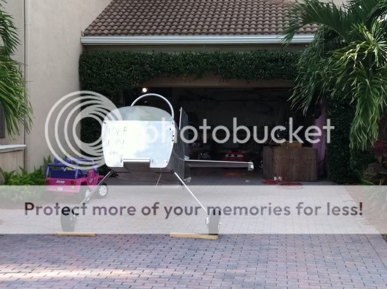

Just wanted to update:
the new setup no longer has the Felt. Its a plastic/rubber seal. Looks pretty tight and sealed regarding dust and dirt... not water.
To everyone else,
Thank you very much for all your insights and information.
She left the shop for the first time today. She enjoyed the sunshine while I am now the crazy guy thats been building an airplane in his garage. Many neighbors... many questions... then cocktails on the driveway
