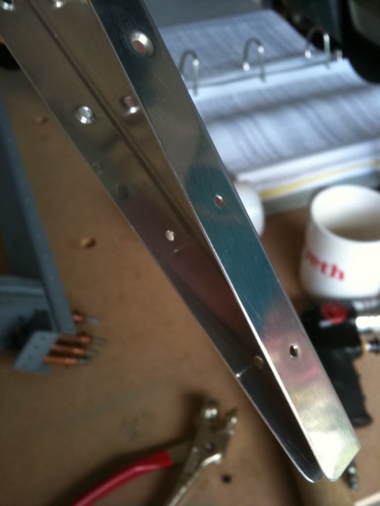

Does anyone have a good way to dimple these last two holes in an RV-9 flap rib? On the other flap I spread the rib flange and slipped in a pop-rivet dimple die, but that was a pain.

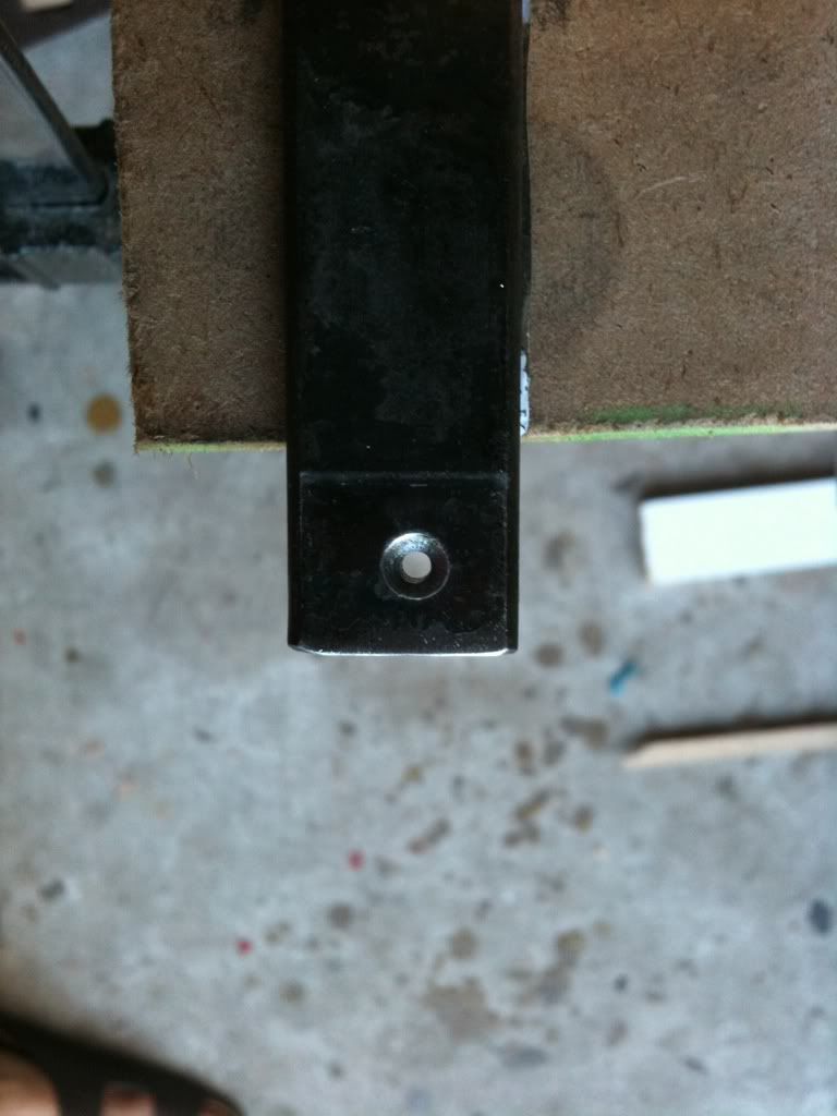

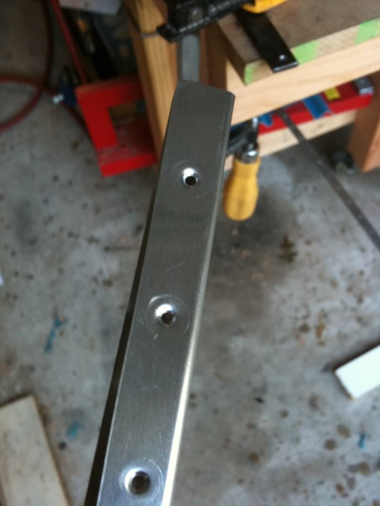

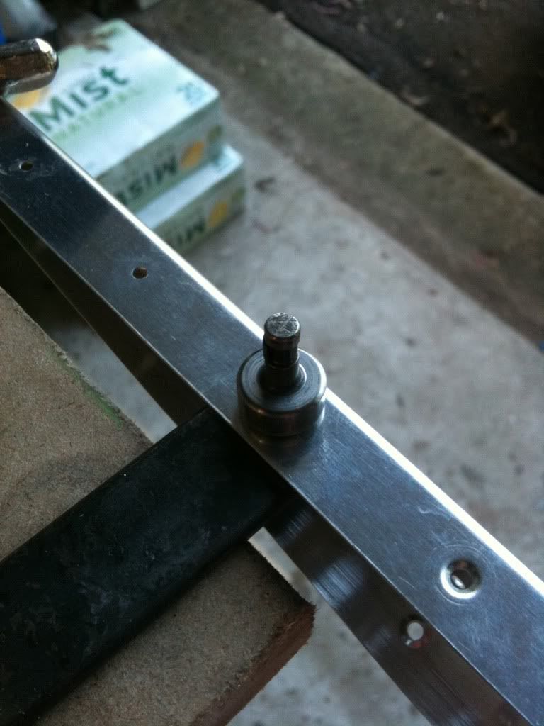

Such an elegant solution. I drilled a #40 hole in some steel stock, machine countersunk it, then hammered a male dimple die into the countersunk hole. Worked great! Thanks Vlad....
Countersunk hole in steel bar:
Male die in hole:
Resulting dimples:

New builder here and late to the game, but thought this might help someone. I was researching how to better dimple in narrow spaces and found this post. I made the same counter sunk dimple "die" out of a steel plate, but made the end more pointy. I kept getting smiley faces in the metal using a rivet gun. What ended up working for me was to use the no-hole yoke in my hand squeezer and the male dimple die in the set holder. It takes three hands, but slide the flat side of the no hole yoke under the steel plate, male die through the hole and squeeze. I'm just working on the rudder and all that might not fit later on, but so far so good.
