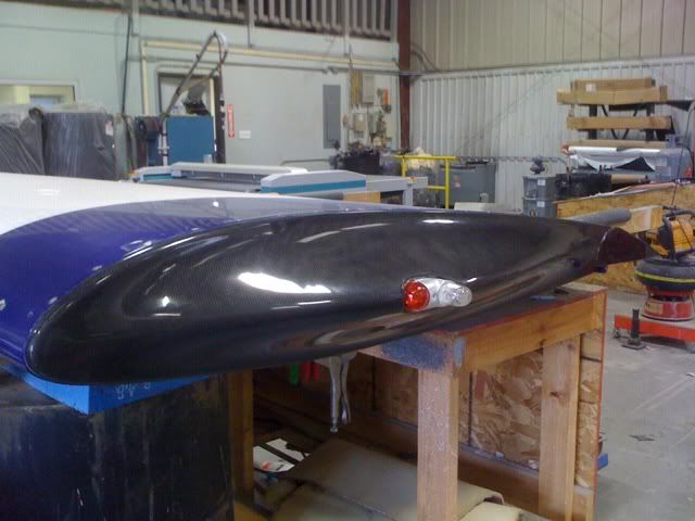

These are kind of elliptical. Need a view from overhead to show a little better. I don't know what, if any, performance affect they'll have, but I like the look a lot more then the stock tips. At the very least though they took off about 10 lbs.

Old 06-01-2011, 04:25 PM
Cfrisella's Avatar
Cfrisella Cfrisella is offline
Join Date: Aug 2008
Location: Sun city, Ca.
Posts: 255
Default As Bob reguested

Thanks Chris...they sure look sharp! I'm gonna ask Paul, you and others following this thread a few questions...but please don't take them as criticism...its all geared towards tip development and educational discussion.
Here goes:
In looking at Chris's tips, I believe I see the following:
1. An edge around the circumference of the tip, that is somewhat sharp, but slightly rounded.
If Chris had made these tips flat, they would look very much like my flat racing tips (just way nicer!), shown here:
2. An elliptical-ish extension from the middle of the tip, almost like an extrusion, or a bulbous (not the best word to use) push-out of the tip. The shape is biased towards the leading edge a bit, especially if the aileron is included in the tip chord calculations.
3. An aileron end-cap of sorts. It looks as though there is still a space between the aileron and the cap, as there is at the trailing edge of my tip. However, Chris's aileron cap obviously moves with the aileron, as opposed to my fixed trailing edge (of the tip).
Questions:
- In a true elliptical tip, would it be better to not have that edge lip? In other words, have the top and bottom of the wing and the top and bottom of the tip be flush...then perhaps taper slowly to the outer edge of the elliptical tip.
- Or is this a beneficial combination of a sharp-edged tip (higher Oswald Factor, longer attachment of the vortex) plus an increased wing area in an elliptical shape to reduce the overall vortex that remains?
From Paul's earlier statements, these two characteristics may be in opposition, but ya never know...it might be a little "discovery". (Chris, did you engineer any of this with these things in mind?)
Would the elliptical shape be better if it was centered along the chord line, and included the aileron portion as well? That would be harder to fabricate with enough strength to extend alongside the aileron, since there is no support back there. Just mulling over the difference in a full-chord elliptical tip versus one that only covers the wing chord, and not the aileron (like Chris's).
Chris, does the aileron cap have a gap between it and the aileron, and if so, how is it attached? (Just hard to see that part.)
Any controllability issues with capping the aileron like this that anyone can think of? I've heard reports of winglet-like end plates loading up ailerons and making the contols stiff, but nothing about caps like this. The EVO wing looks a lot like this in the aileron area (just smaller), but this may be a different aileron design, so just wonderin'.
Along those lines, any concerns of aileron flutter when adding a cap to the outer edge of the ailerons? I know some folks have filled the tip rib outboard of the aileron, but I don't know if anyone has filled the gap in the aileron, or has capped it. These look very lightweight, but just thinking about all issues, since its a departure from plans (not a bash there!). Thoughts?
Chris, they really look sharp...just beautiful work sir, so these are just experimentin' questions. I'd love to hear Paul and others' thoughts about these versus Jim's tri-tips, and other designs (and don't use too many 5 syllable words on me now Paul! )
