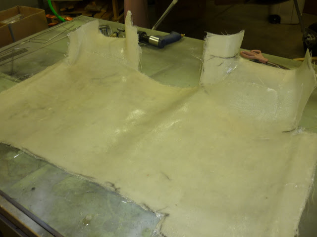

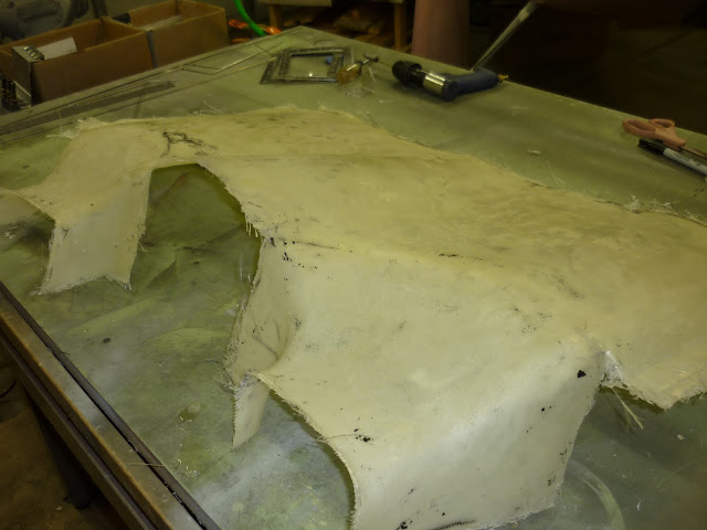

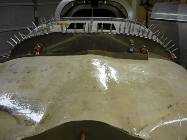

Thought I would share the beginning of my plenum building..Last night I cleaned and waxed the mold (made from upper interior cowl) and layed 4 layers of S glass. I just got finished pulled the dried epoxy/glass and I am pretty happy with the initial results. It will need a little modifying, but all in all, very good so far....more to come...
the Mold.
While pulling out of the mold...it released very easily and I only cut myself a few times on the edges

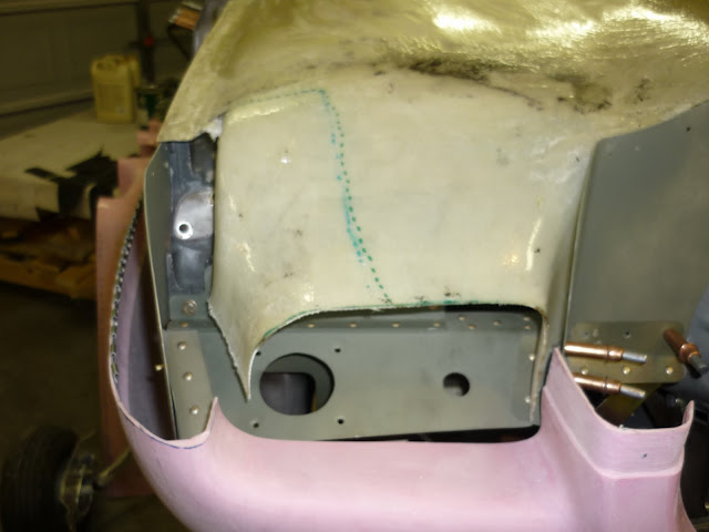

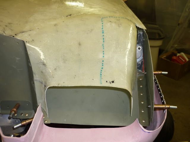

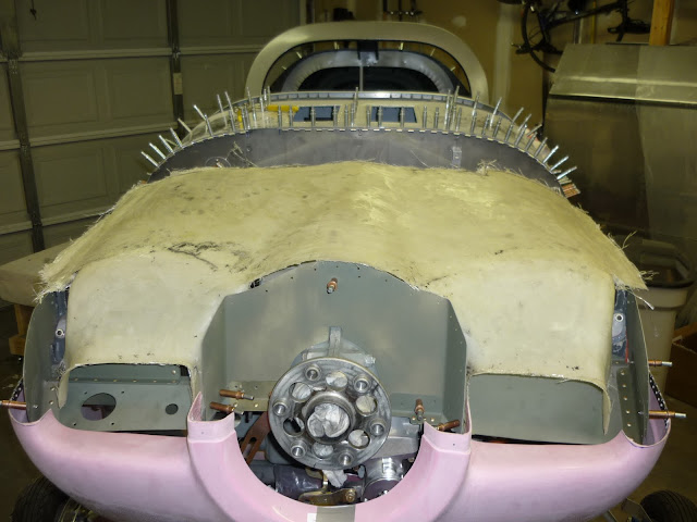

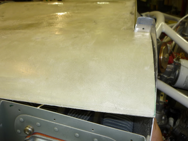

I little more progress here. Cleaned up the edges and fitted it to the baffle...mostly.. Still some work to do on the left side rear, there is a gap and I have not decided how I am going to handle this yet. Also, I need to rework the inlets and widen them about an inch.. Haven't decided the best plan of action there either yet.
Left side rear gap.
I am thinking possibly to cut on the line here and move the outer piece where I need it and then lay glass over the gap.. ??

Your idea for the inlet widening is fine. Just grind the edges down to a thin edge, creating a tapered lap joint with the new glass.
Same thing for the gap in the back. You can tape a piece of cereal-box cardboard inside to form the shape a little bit, cover it with packing tape, and build up glass over it to extend the edge of the plenum out to where you need it. Again, just grind a scarf angle on the original glass to bond to.
The tricky part is going to be making the rubber boots to seal the plenum to the cowl intakes. Dan Horton has made some interesting reinforced rubber parts, you might check out his postings

Looking good Ryan just watch that gap between the cowling and plenum by the prop.
