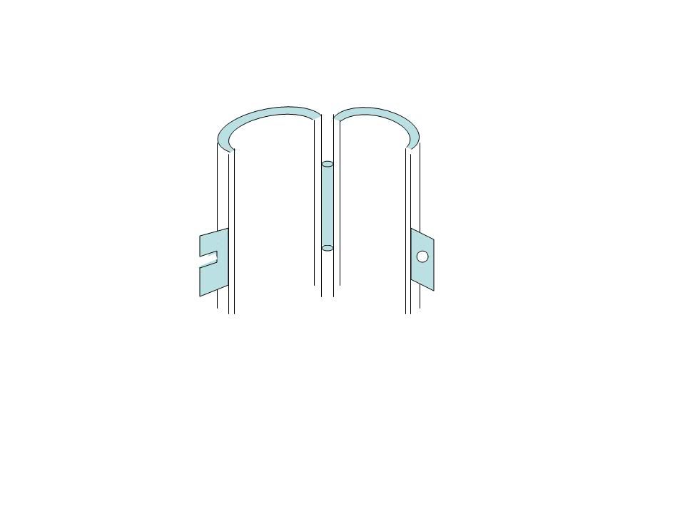

Looks good. How about if you hing the other half of that PCV pipe you have on the stick so that it swings around the whole stick then secures with a wing-nut? That way you could shorten the pipe from the rudder pedals to the stick and get the elevators in the neutral position - and you won't need the zip ties.
Something like this? - Course then you'd need something similar on the rudder pedals...

Without the stick being in the full back position, nothing would be pushing on the rudder peddles. The ruder could flop around.
