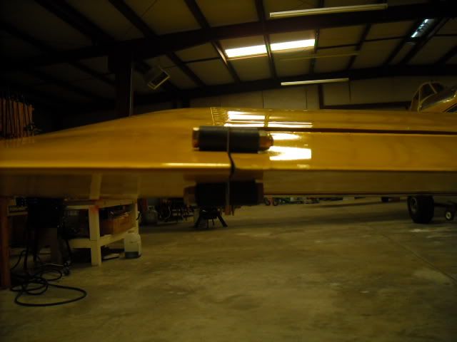

Since the thread on rudder locks had a lot of action, I decided to show my aileron and elevator locks....cheap, simple, quick-to-make and effective.

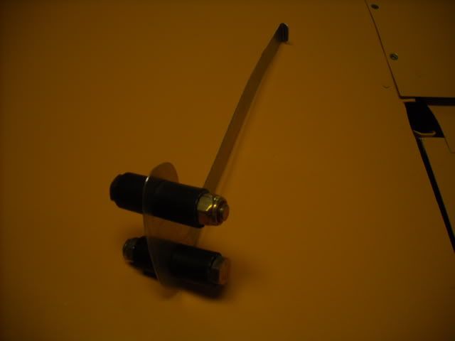

A piece of .025 aluminum and a couple of hardware store bolts and a piece of rubber tubing: The aileron lock:
Because of the taper and the smooth paint, I needed to prevent the lock from sliding off the aileron/wingtip junction, so I added a piece of .025 with a hook on the forward end that goes around the aileron attach bracket:

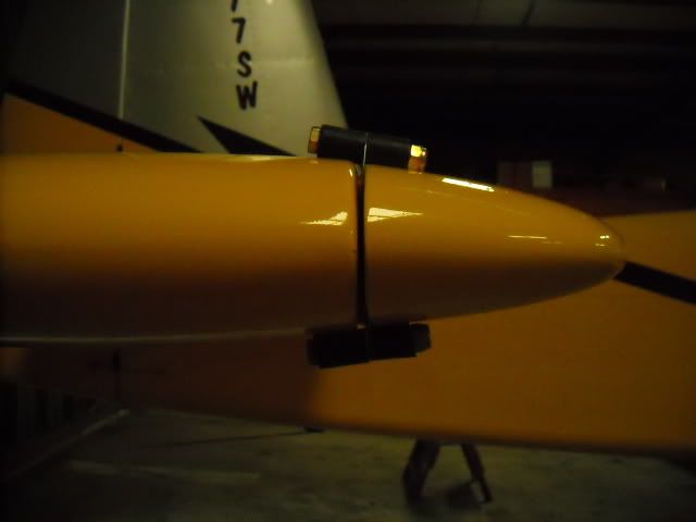

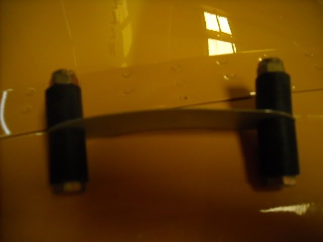

The elevator lock is similar:
Just a piece of .025 and rubber tubing that is a larger diameter than the bolt heads so they don't scratch the paint:
They can all be made in under a half an hour,

Do you have one for each side, for the ailerons and elevators, or is one each for the ailerons and elevators sufficient?

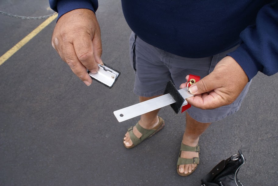

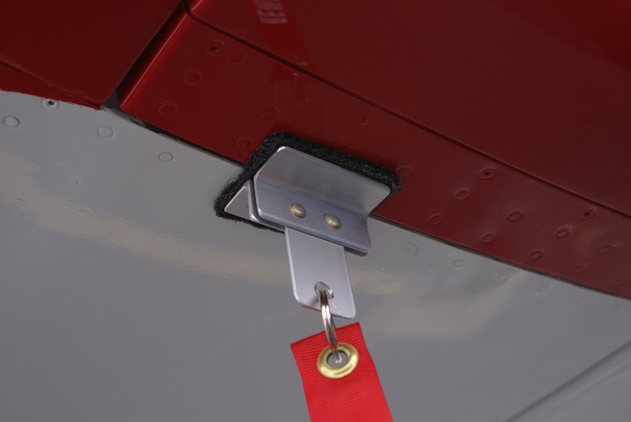

Here are a few shots of a simple and elegant lock that I saw at the Homecoming a couple years ago.
The owner was kind enough to let me take the unit off, so I could get better photos--------Unfortunately, I do not remember his name, to give proper credit where it is due.
