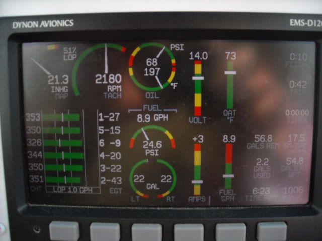

Default Well, our -10 got 17.5 mpg
:.....and under 9 GPH at 51% LOP this afternoon: Jenny and I did a short XC and these are the numbers:. The MPG and the range are on the far right side. Note the range is over 6 hours at this power setting vs. 4 hours at 75%.
We were only at 3,000' and our TAS was over 150MPH and the range had climbed from less than 800 miles to over 1,000 as depicted by the D-120...lower right.
On a short trip, the time saved running 75% is minimal...this one was 50 miles and took 22 minutes at 51%/8.9GPH and 17.5 MPG, whereas at 75% it took 20 minutes at 75% with a 50% greater fuel burn on my IO-540/260 HP Lyc. getting 12 MPG. We had a 90 deg crosswind both ways.
Don Rivera showed me how to really raise my MPG to the most efficient point if I didn't mind going slower...and here it is.
