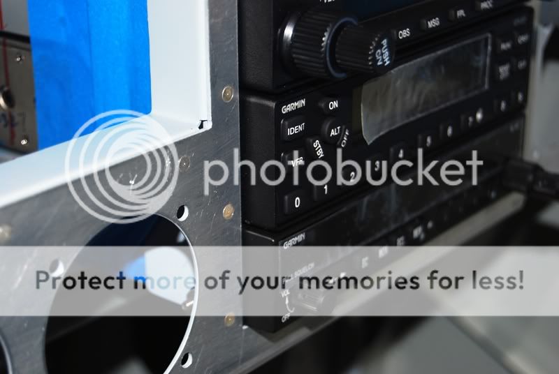

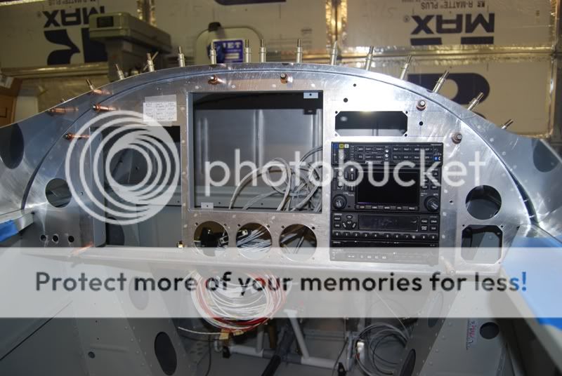

For my stack, I have (from the top) PMA8000BT Audio Panel, 430W, 327 xpndr, and an SL-40 (the long one) on the bottom. I originally had the xpndr on the bottom, but the SL-40 hit the brace. By moving it to the bottom, I was able to get it just under the brace. Clearance is rather minimal, but I believe that with good bracing and probably a rubber bumper in there I will be okay. I'll try to take and post some pictures this evening. Even clear of the brace, there's only about a finger's width between the back of the SL-40 and the bulkhead.

View of the SL-40 under the brace:
Tighter shot:
Bezel alignment relative to the instrument panel face:
Panel overview:
AFS-4500 in the middle (due to ship in 4weeks), 696 on the left.
