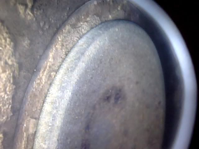

Can I suggest you look up the AVWEB articles written by JohnDeakin ...around article 64 or there abouts are 4 articles on how to run your engine.
PRINT THEM OUT
READ THEM
..............and read them every night before bed for about 3 weeks..........YES I AM SERIOUS
Then when you understand the whole combustion process and how to run your engine...........you will be
I assume these are nice looking valves! .......... only 330hrs since new
And the pistons are the cleanest I have seen on any engine after 330 hours too.
Exhaust valves
1.
2.
3.
4.
5.
6.
