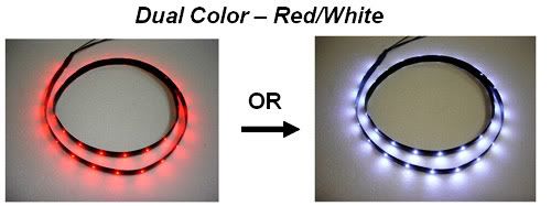

I am putting in the cool LED light strip under the panel. It is red and white. This I guess requires some way to control each color.
Is there a way to dim and control each color with a single switch? The switch I saw in the Spruce catalog is a two knob assy. and big.
I have these lights
and this single channel switch
Perhaps I need this 2 Ch switch
What I am hoping to have though, is some way to use the single CH switch or even better yet, a single switch that is a 3 way, rheostat red or white light position. Has anyone found such a switch? I think I could put a toggle switch in and connect it to the dimmer, but then I have two seperate switches to essentially run one light source.
