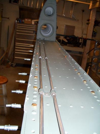

I've got the Safeair mount. New installation, not a retrofit. The mount comes with a diagram to position it correctly on the skin and spar. I did have to relieve a couple of notches where the flange on the mount overlaps the rivets on the leading edge skin/spar. You should be able to see them in this picture on the right side.
Opening up the hole in the skin is pretty easy with a unibit and dremel tool.

This wasn't a retrofit, but just to give you some ideas:
I installed a pitot mast during the build and also routed two lines to the pitot for a future AOA upgrade (I have a standard Cessna style pitot right now). I ran aluminum lines in the same general location as the RV-6 plans. I termintated both line at one of the ribs with bulkhead fittings and made a second line from the bulkhead fitting to the pitot. With the tank removed you should be able to get a second pitot line routed through the outboard LE. If I were to do this again, I would just use the hard plastci tubing, but I didn't know that existed at the time.
Rather than have the bulkhead fittings like I do, you could just route a new line through the LE and down to the pitot through one of the lightening holes. Run it behind the tank along the spar and into the fuselage. Shouldn't be all that difficult.
