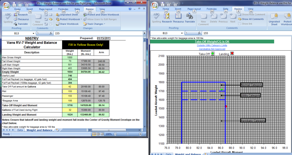

Old 01-15-2011, 08:21 PM
DakotaHawk's Avatar
Location: Arlington, WA
Posts: 799
I have a W & B spreadsheet already set up for the RV-7 (includes arm distances based on Van's specs). It gives a picture/graph to show if your weight/balance is ok for Normal/Utility/Aerobatic category of flight at take-off and landing weight. You should be able to plug in weights for each wheel and get correct results - as long as your wheels are all where they belong!
Send me your email if you want the file.
