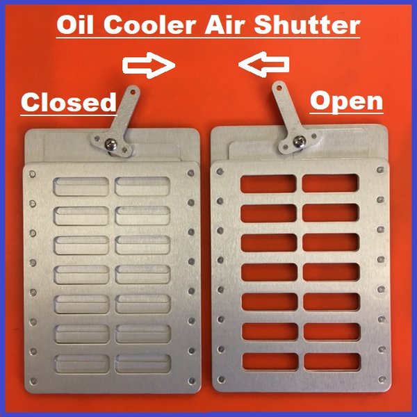

The shutter door is no longer available at Vans ! Do you know anyone that wants to sell theirs?
Allan has a new shutter product engineered with van's as the model.
https://antisplataero.com/products/o...er-air-shutter
