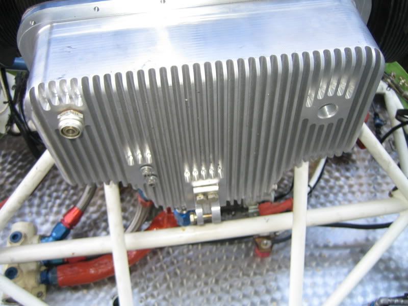

speed brakes are very nice when you are running a turbo. Open the waste gate @ 11500 leave throtle wide open and nose it over @ 2000 fpm no pitch change 180 ktas no speed increase lower alt like 8500,I can do 3000 fpm no problem full power open wastegate
turbo-normalized 9.5:1 is no sweat. Intercooler lowers the intake temp to prevent detonation. Its only when you get up to 38-39' map its going to be a problem. but not at 100 LL fuel and there is alot of peoble saying this and that but really this is very safe. I can run this thing 110 % power at 11500 alt and 2300 rpm and 14.7 gph very easy. come and se for your self
doug what is "t/o mp" sorry cant ansver if i dont now what it is
the hottest i have seen on a 24 celcius day was a climp from 3500 alt to 11500 alt 32' mp @ 1500 fpm cht was on # 3. 406. F and oil was 220 F and as soon as i level of it fell to 197 F and cht was 368. F
heres a picture of my oil scavenge pump and oilpan

Now this puts the E (IN BOLD) in Experimental. All the oil lines look like a snake pit! I would expect higher Temps with the power output you are now getting. Your cooling plenum is successfull also. Great job!

That is some VERY nice machine work! Careful as you will get others who want one. (Like me!)

I would love to see a photo of the lower cowling because it looks like it would need modification. Great looking install tho!!!

I'd like to add some suggestions for using the oil pan with cooling fins to aid oil cooling. First, to be really efficient, you need to place a sheet of metal over the ends of the fins to form a plenum to keep the air in close contact with the fins. Second, you need to feed this plenum with outside air, not the hot air off the cylinders. Third, long fins build up a boundary layer which inhibits heat transfer from the fins to the air. This can be overcome by making the fins wavy rather than straight, or making the fin surface very rough to promote turbulence and scrubbing-off of the boundary layer, as smooth fins result in lowered heat transfer. 'For what it's worth!

If that is what you want for you system. Ill be happy making that for you, it adds to the price just so you know.
I just needed the stiffnes and strengh to hang a turbo from it with out the extra lbs.
Its a good idea and maybe worth looking in to.
Thanks for the input
for the other question about cowling i think i have enough room in a stock cowl. Maybe open it up just a litle bit. Mine was big to begin with, Ill post some pics later
