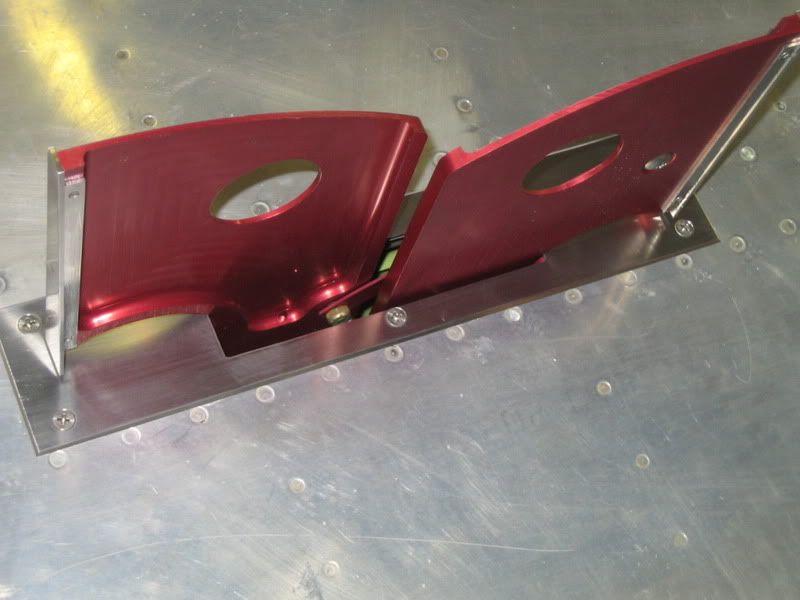

Do you have some pictures of the custom parts? You can't really see them under all pipes.
You have also answered the question regarding speed brakes on an RV.
With the brakes out, how fast do you come down and what attitude change does it cause?
