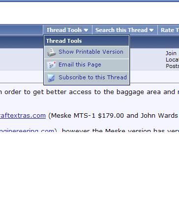

Default OT
Is there a way to "subscribe" to a thread without posting a reply in the thread? (This reply is to subscribe to this thread )
At the top of the thread, look for the "Thread Tools" pull down menu...

Cool, and easy. Thanks!
