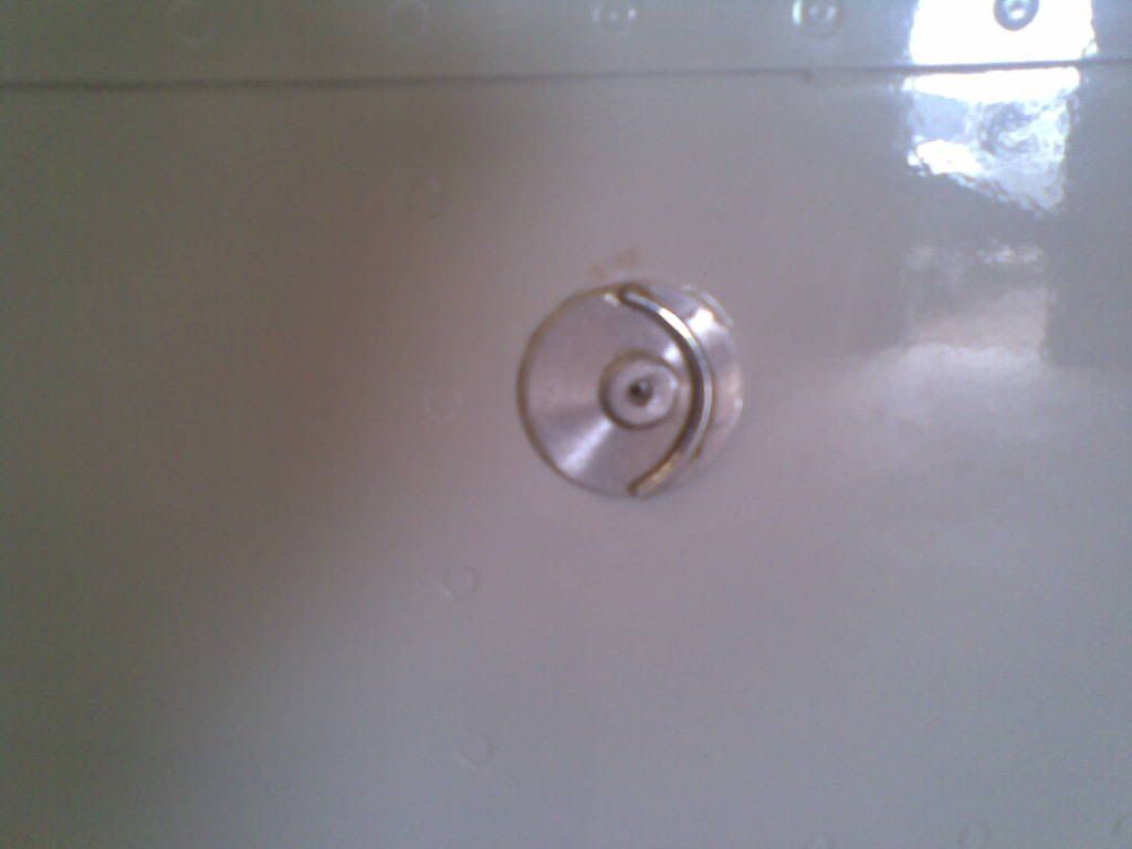

O.K., are you cutting them in half first? so they look like the setup in this photo I borrowed from David?
Hey Mike:
I am referring to the wing mounted mast type pitot-static devices. The O ring is sized to slide over the tube and adjust the static pressure in flight. The picture you posted shows one method of tuning the fuselage mounted static ports...
Sorry for any confusion!
Carry on!
Mark

Mark, thanks for the clarification------
