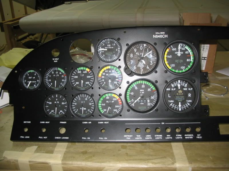

Posts: 3,179
Here's a pic of the cub panel Yakdriver built recently. Nicely done
