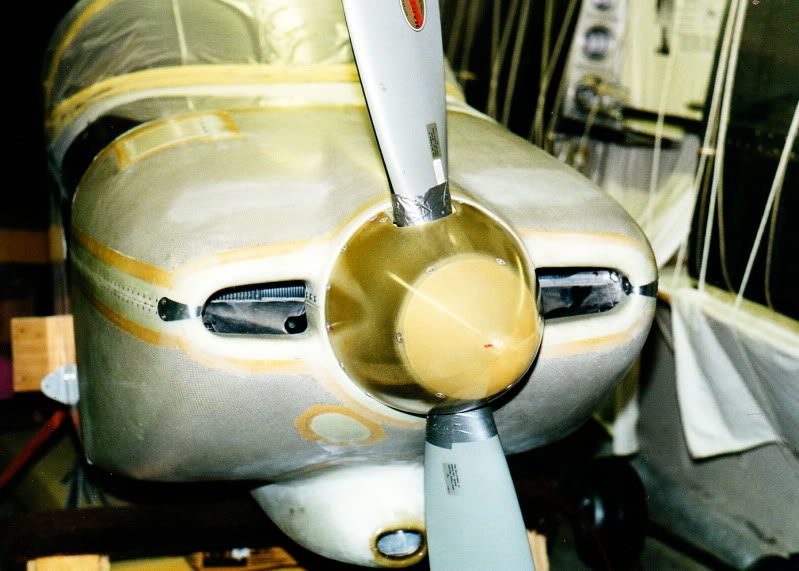

Old 11-07-2010, 11:11 AM
Posts: 5,685
Default My covers
The first photo was taken when I WAS INSTALLING THE COWL IN 1999. The covers are made of 0.016" 2024-T3. They are each mounted with 3 #8 flat head screws and platenuts. Originally the platenuts were all mounted directly on the cowl fiberglass inner flange and the two outside fastener locations still are but after a couple of years of operation one of the inner locations gave out and I had to install those two inner fastener location platenuts (one for each cover plate) on a backing plate of 0.032 2024-T3 aluminum. No problem since then. The second photo was taken on 6-22-2007 when I was experimenting with inlet size reduction plugs. The inboard mounting screws for each coverplate go through both the upper and lower cowl interface. The cowl outer surface is countersunk and the cover plate holes are dimpled.

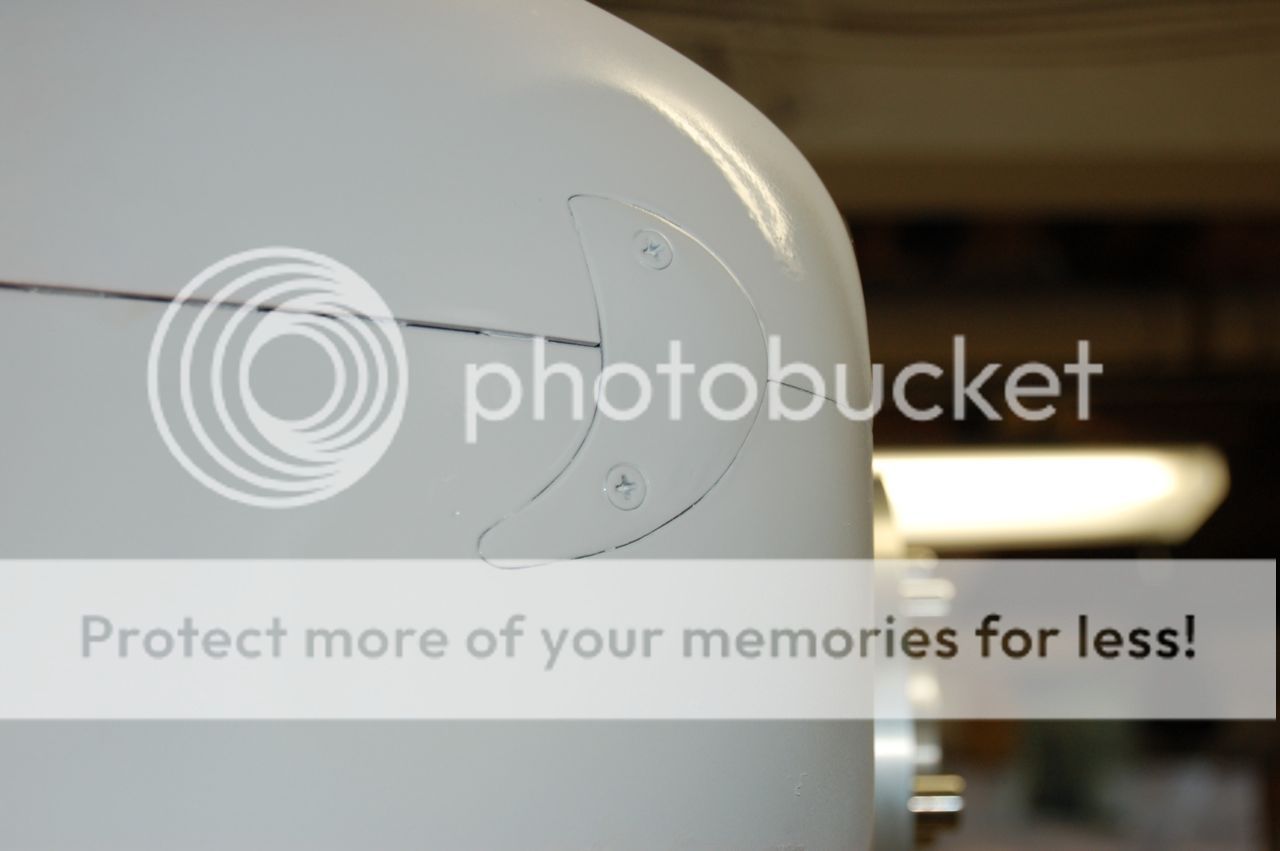

I duplicated the cover Wayne did on his award winning 7. I saw him removing the cowling for judges and took couple pictures
I spent couple evenings on them. Printed first picture full size copied the cover then made it. The method is written on Walter Tondu's website.
