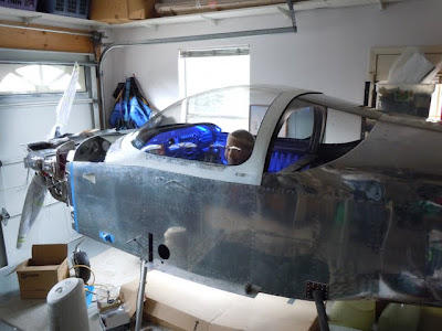

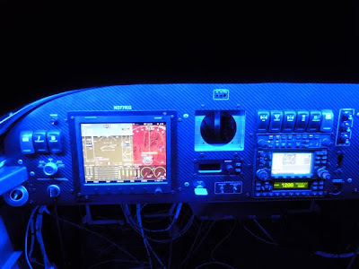

First photos of the end product: The strip is on a dimmer, this is full blast at night with all lights off in the garage. With this on full blast you can see throughout the cockpit. I wont need any other cockpit ambient lighting. The glow is comfortable and very cool. Dimming reduces canopy reflections.
My son works the panel, while I take the picture. Here you can see the individual LEDs on the right edge. Inside the cabin you dont get any direct view only the comfortable glow. I have have an edge installed on the glareshield.

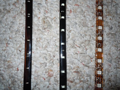

I bought 3 different LED strips to experiment:

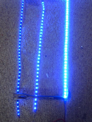

All driven together with a 12V power supply:
On the far left: 120CM LED strip bought off ebay for $5 shipped. version SMD 335.
Center: 120CM LED strip from EBAY for $15 shipped.. version SMD 3528. 1.44W/foot, 0.12A/foot
Right: 4ft LED strip from www.ledlightsworld.com. This is what I installed in the plane. Cost $60 shipped. 3ft would have been enough and would have saved $13. Version 5050 18 LED/ft. 4.32W/foot, 0.36A/foot. So my 3.5feet put out 15 watts at 1.26A at full grunt, I have a dimmer installed on the panel.

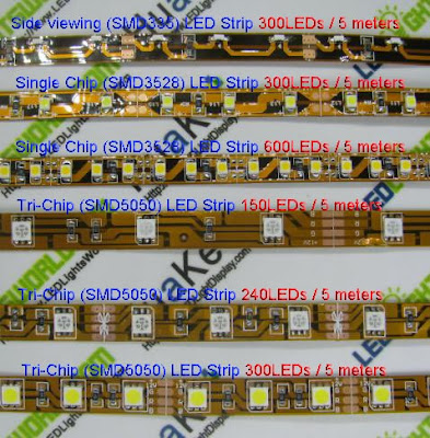

A good reference photo I found with all the various versions of light strips:
Bottom line: I am very happy with the SMD5050 300LED/5meter or 18 per ft version of the LED light strip. At total of 15 watts, it provides plenty of light at a soft glow that impresses all who see it.
