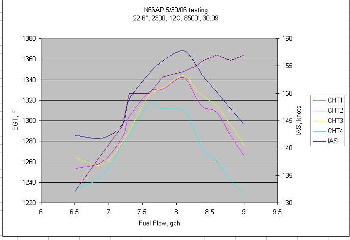

It is normal to see the rise again, although at only 15 LOP, I'm not sure. I understand it is called lean mis-fire, where the cylinder becomes so lean that it doesn't burn properly. On mine, it takes something like 100 LOP to see it. However, I run dual EI's on mine, if you are running straight mags, it might occur much sooner. I know when I had the Lasar system, and could revert to straight mags in flight, I could not go much lean of peak before roughness. EI really shines LOP.
Run the fuel balance and see where things are - that cylinder may just need a little larger injector.
Here you can see a couple cylinders started to trend upward:

Alex,
I think the IAS plot is lying to you.
There's no way IAS will increase when LOP, the engine is producing less power.

Originally Posted by David-aviator View Post
Alex,
It looks to me like IAS is going down after EGT peaks, as it should.
You are so correct!

As for the temp goling down and then back up, I don?t see it in the graph. Is it normal to go down and them back up?
Look at #4, that's what Alex was referring to. EGT levels off, starts to go down and then goes up some more. #1 #2 #3 are smooth curves, #4 is not.
I see it sometimes with #1, it is an aberration of a sort.
