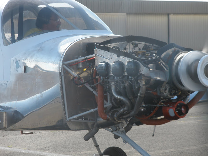

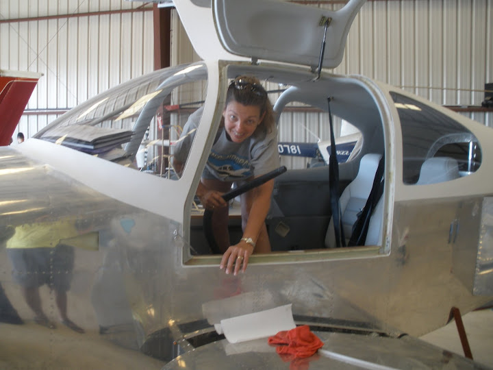

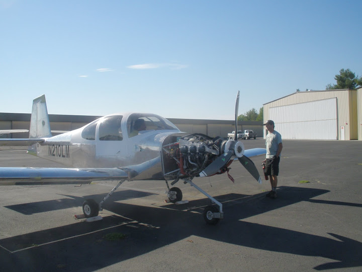

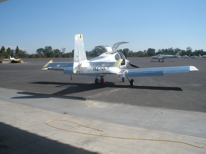

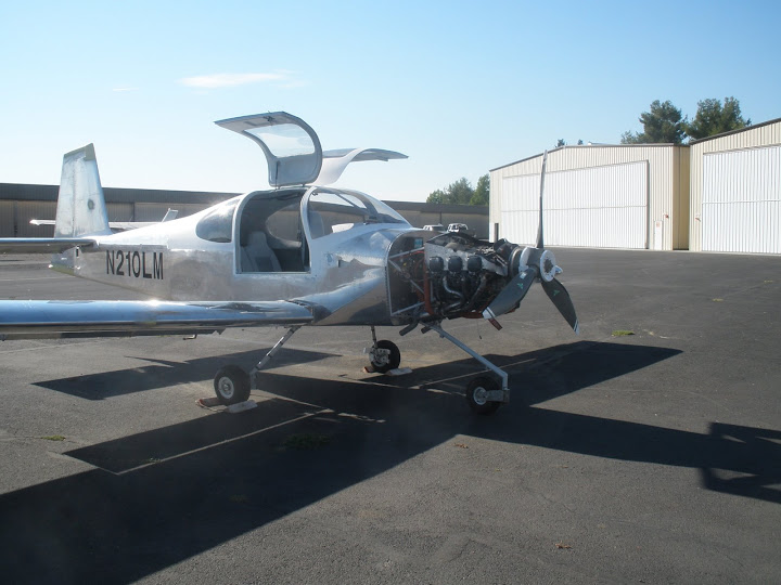

Airframe pretty much together and ready for inspection.
Here is Laura vacuuming out all the little hidden treasures that come out of hiding after the ride on the "scary trailer" as she called it.

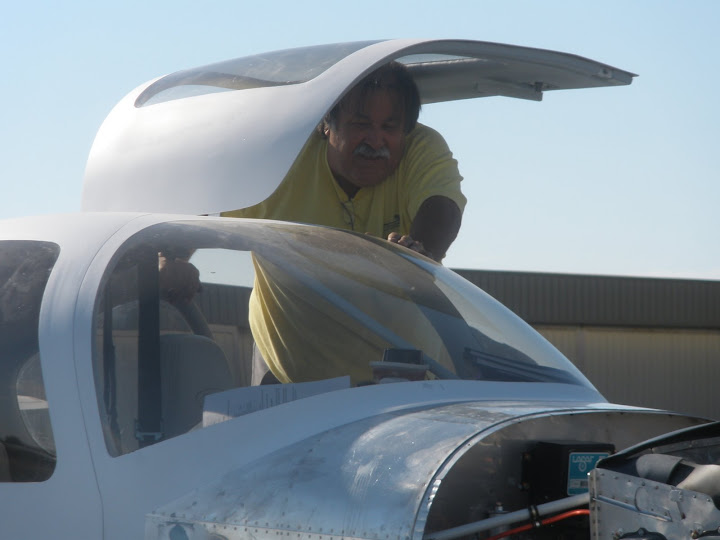

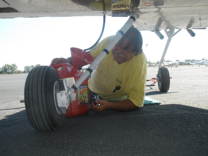

Time to run some fuel through the tank, flush out any goobers hiding in there.
Both tanks flushed, fuel flow checked ---apx 30 gph---oil pump putting out to the pressure tap, guess it is time to see what happens when you twist the key Chocks down,
Pilot (??) committed.
Fire extinguisher at the ready-------
Too young to smoke.
Time for an adult beverage.
Engine smooth, Prop cycles just fine, temps OK, Tach not working, oil pressure too high---99---hopefully just a calibration thing.
Did I mention time for an adult beverage??
