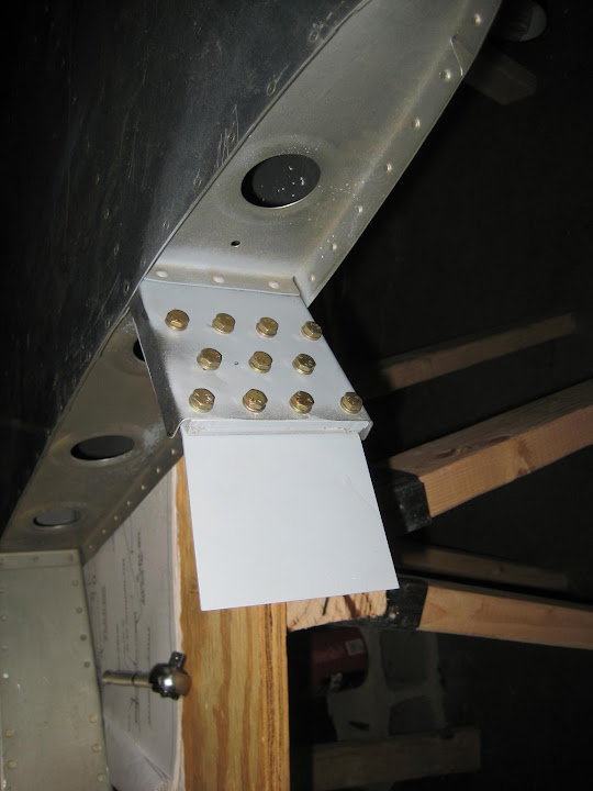

Paul,
I had the same problem on my 8 when I fitted the empenage. Would post a picture but never learned how to post pictures.If you will go to my builders page in kitlog click on all and go back to 8/07/07 and 8/16/07 there is some pictures of the spacer I made. Never really figured out why I needed the spacer but suspect my jig position on the rear bulkheads three other 8's where built on this jig don't know if they had the problem but I made the spacer and built on. The picture you posted the spacer is on the same side of the spar as mine was but in the picture posted by someone else spacer was placed on the opposite side of the spar. There is a link to my web page on bottom of post.
MIKE WARREN
RV8 N184MW RESERVED
TMX-IO360 REDGOLD,HARTZELL CS
CLINTON N.C.

I'm not sure how to grab someone else's photo and post them but the photos he refers to are at: http://www.mykitlog.com/users/displa...g=39620&row=96 and http://www.mykitlog.com/users/displa...g=39622&row=94
Here you go Louise, and a thanks to Mike (RV8MW):

Originally Posted by RYOUNG View Post
I moved the horizontal stabilizer aft [edit] 3/16" by placing a 3/16" spacer between the front face of the horizontal stabilizer rear spar and the fuselage attaching bars.
Robert "Earl" Young
RV3B
That would have been the easiest thing to do - if we hadn't already drilled the holes in the longerons for the forward attachment bolts when we found the mismatch in the vertical spars....

Moving the H Stab aft might limit the 'up' angle of the elevs, as the aft bulkhead is (or is supposed to be) the 'up' stop.
