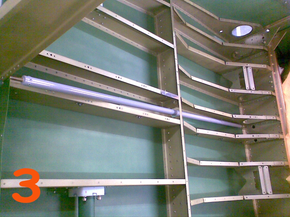

You do not need any flex or force to put in the controll tube. I made a serie of pictures (step by step) with my mobilephone, how to insert the tube with just two fingers and no force.
Now I have to work, I will post the pictures when I'm at home this evening.

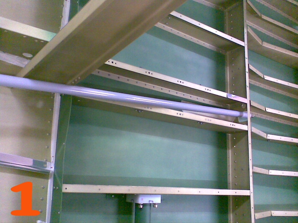

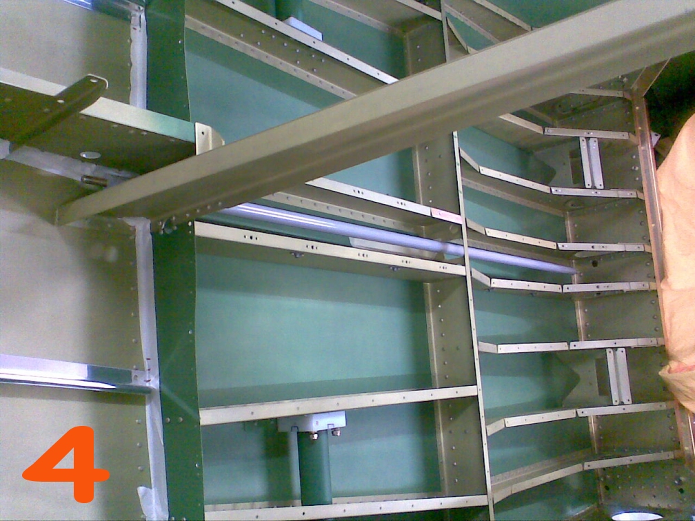

Default Step by Step
Hello Bob
here are my pictures. Sorry about the quality, I made them with the mobil phone.
I made my tube by 1/8" longer, I like to see a few threads more engaged, so I was really alarmed when I have seen your first post!
* I slided the tube in from the back to the front
* on the right side, along the bellcrank channel F-728
* throu the rear spar bulkhead F-705 bulkhead, untill it hit the main spar web,
* then back throu the bulkhead F-706B until it sits on the correct position.
I hope all is fine with my controll tube, because I can really put it in with 2 fingers!? So please check my methode and report, so that I can go relaxed to bed and not have to fight against bad dreams (:-)
Regards,
Dominik
RV-7A
Switzerland

Dominick,
You have provided a great end to this post. Your pictures say it all. I just didn't think outside the box...literally, it just didn't occur to me to go outside the center support at the bellcrank bulkhead. There is a couple more inches between the 706 bulkhead and the main spar than between the 707 bulkhead and the 705 bulkhead. Even though I have already "flexed" mine in, I think I'll take it out, paint the scratches and PUT IT IN RIGHT. Sleep well.

After you installed the tube, check clearence at the rear-spar bulkhead. At nearly all RV-7, the tube is touching the rear spar. It is ok to grind the spar there in height by max. 1.6mm. PM me if you need a picture.
